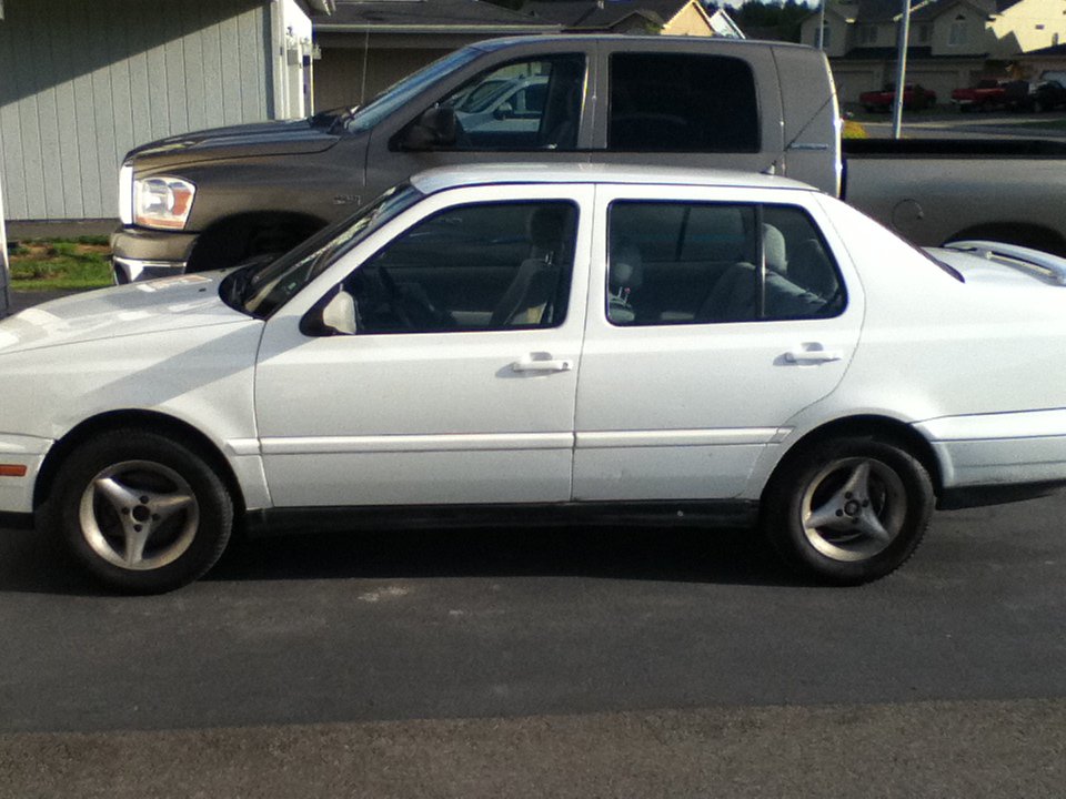

He has a 2006 5.7 Quad Cab auto seen behind my first car that is totalled now
