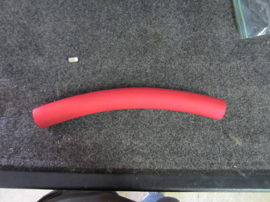

Got some pics for ya. As Hammer said, I did a gear change in the rear, but didnt want to do the front. So yeah, I have removed the front drive shaft for the summer months.
Job was fairly simple. I removed the small clamp on the rubber boot and slid the driveshaft yoke out. I then took a piece of hose (1 1/4 i.d. I believe) and slid it inside the rubber boot and over the output of the transfer case to protect the splines from dirt.
