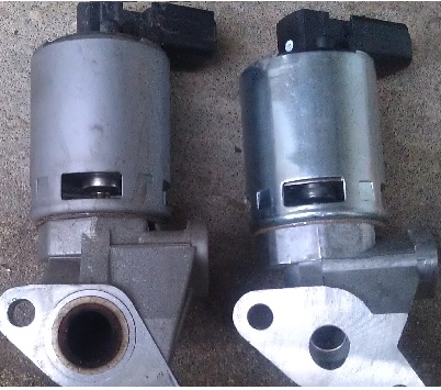

I went to replace my EGR valve today and the new one has a smaller opening than the old one. Will this affect anything, or should I take the new one back and get a different one?

We replaced the EGR in my 06 ram last year and it fit perfectly. I would assume it is supposed to.

Won't hurt. Put it on and make sure with the gasket.

Alright, thanks for the help
