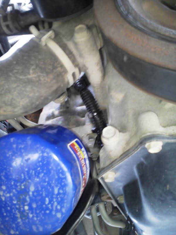

I found the problem with my 08' Ram ... the wiring harness that runs to the CKP sensor and Knock sensor is routed to the right of the Oil filter and rubs on the sharp edge of the engine. It had rubbed a pin sized hole in the wire that feeds the CKP, when I hit a bump it would make contact and shut the engine down causing the erratic voltage readings on the DTC codes..P1618, P0335, P0642... this could also affect the knock sensor so check there first if you have an issue relating to the CKP or Knock sensor. The best way to find it is to disconnect both sensors and feed the wires back up toward the alternator. a small hole is all it takes!
Attached Thumbnails F855 Primary 5-volt supply circuit Diagram?-08-ram-3.jpg   F855 Primary 5-volt supply circuit Diagram?-08-ram-2.jpg   F855 Primary 5-volt supply circuit Diagram?-08-dodge-1.jpg
