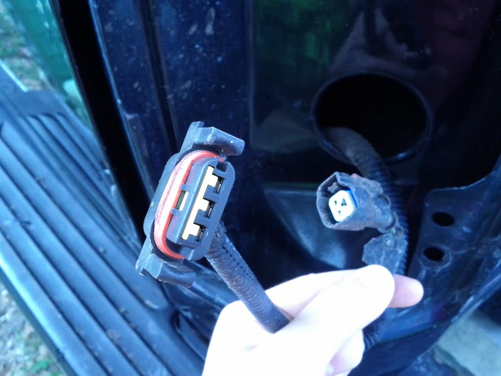

No no guys lol. The wiring is all there I just shoved the ends into the hole so it wouldn't just be hanging out. I'll go snap some more pics in a minute. I already ordered new tail lights off ebay so I just need to figure out if they'll actually attach or if I'm missing more pieces then I think

What about the Plastic piece that holds the bulbs? What about the connector that the wire hooks into?

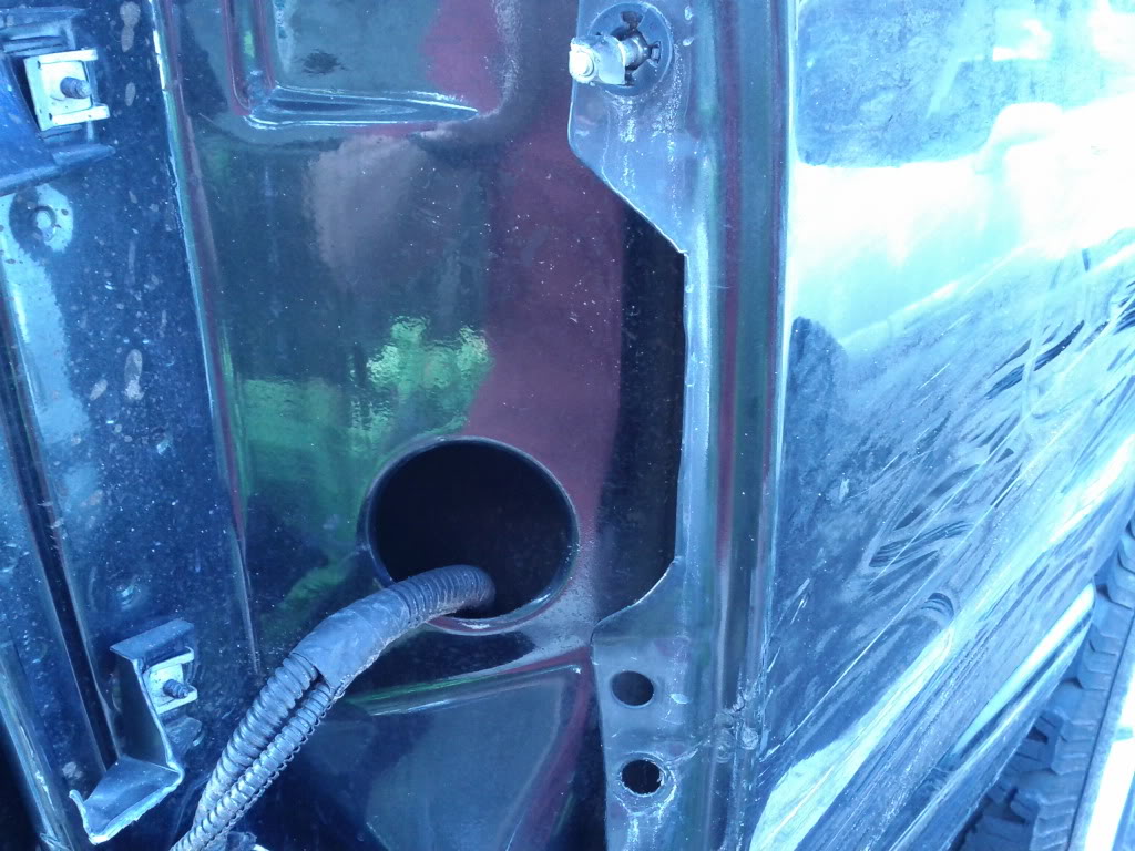

So it looks like your harness is okay (which is good!), bad news is your locating pins on the outsides of the area where the light usually sits are broken, so you will need to get new locating pins from the dealer (no one else will likely have them) then you need to open your tailgate and take out the bolts that used to hold the tail light in, and then you just put the new ones in... good luck and have fun...

Yea I saw on the tailgate side just those plastic pieces broke but the screws are fine. But I was worried about those outside connector pins like you said. Guess I'll have to tape the lights on once I make sure they work so I can drive out to a dealer and see how much the pins are. Probably alot I'm guessing lol
