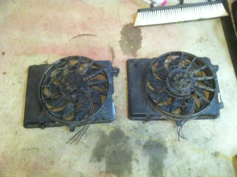

Went out and got my fans today, one of them has a broken housing, so i'll use that one as a backup just in case. Hooked them up to my 30amp 12V power supply and they both fired right up!! one step closer.
