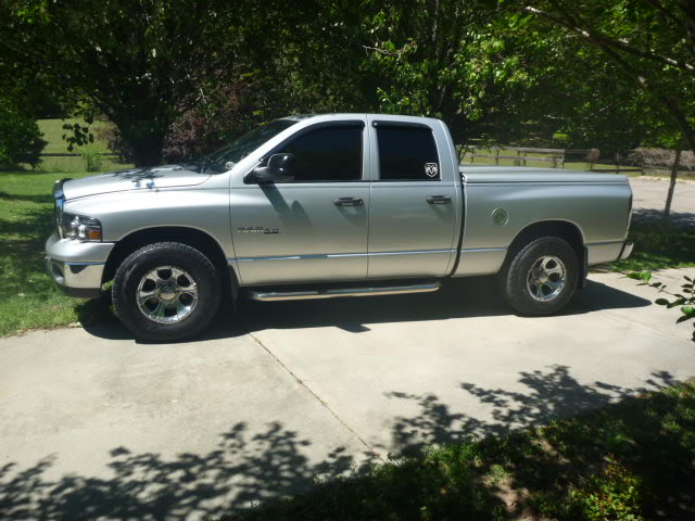

That's the same specs as my DCIIs, except your backspace is 0.05" less. Originally had 265/70s, now 285/70. I do have a 2 1/2" level.

I think it'll be fine with 265s. It may be OK with something bigger. I did my level kit first, then the wheels with 265s. My 285s went on two years later in '09, so I don't know if the 285s would fit without the level.
