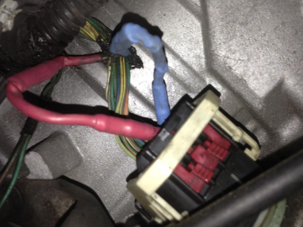

The company are being very helpful, but have asked me to look into a fault which they pointed out prior to doing any work on the truck, before they have it back. I've just been up to a friend with a ramp so we could check it out, see below...
Someone has made a pretty bad repair on this cable. I can only think this has been like it since I bought the truck in Miami 6 years ago, because I know it hasn't happened since being over here. One concern is this repair could've contributed to the original fault which caused the box to need a rebuild in the first place!?
I'm a marine electrician and more than capable of re-terminating this plug, if I can get the bits - anyone know if they are available and where from? I would need a replacement plug and all the pins that go into it, also a crimping tool if specialist. I'm also coming to Canada next week so hopefully might be able to pick up some bits.
I'm just really trying to get my truck running properly as quickly and painlessly as possible, so if that means helping the company out with some info, or checking out some cables then I'm all up for helping out.

Hard to tell where that plug is on the truck... do you have a picture from a little further away, someone might be able to chime in on it.
