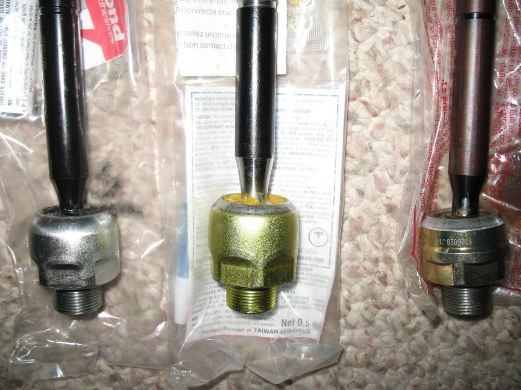

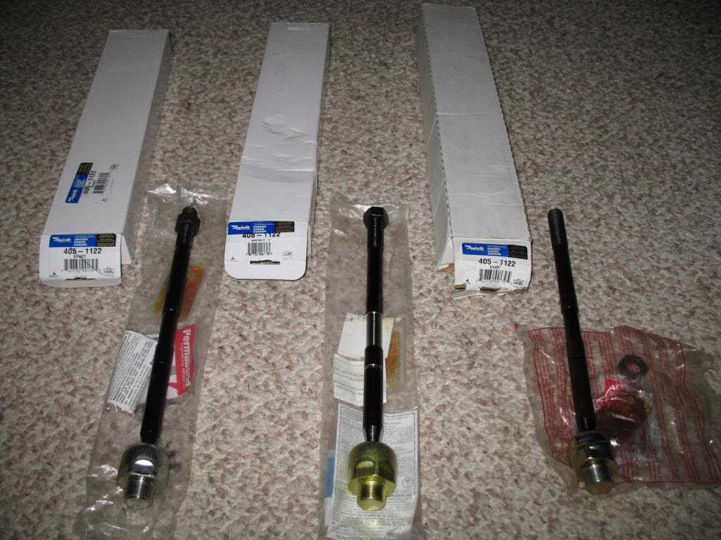

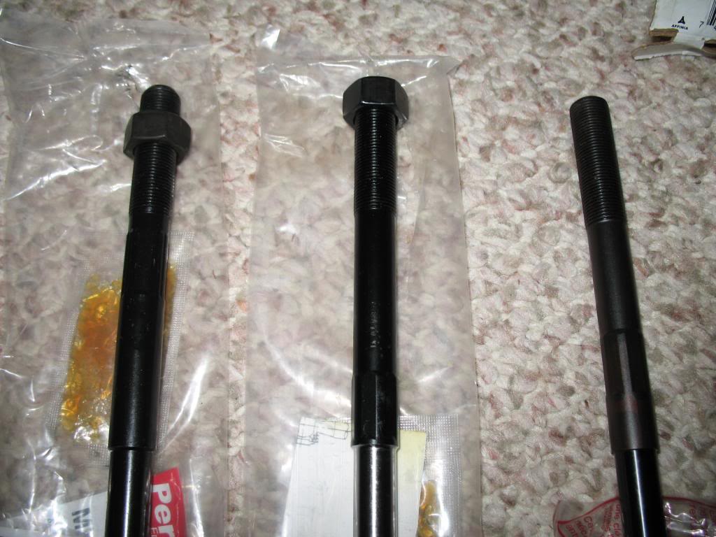

here are all three inner tie rod version that I got with boxes showing part numbers.
I'll add some more pics later as well as maybe edit the thread or start a new one to be more about the work done so far vs "best brand".
