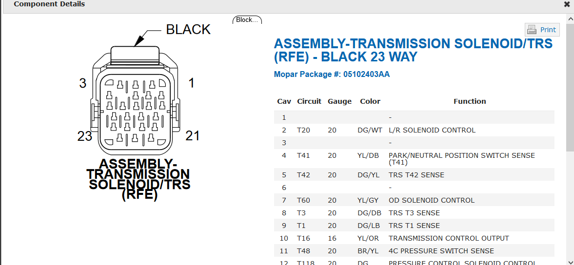

Originally Posted by weedahoe
Thanks. It's this one.
But I don't see a price or way to purchase it.
http://connectors.dcctools.com/resul...70B0DBD94EFAAA

Now that you have the part number, plug it in google and find a better price.
Like this one
http://www.factorymoparparts.com/05102403aa.html
Its going to take a little time and digging.
Maybe wrap a zip tie through it to keep it together as an alternative
