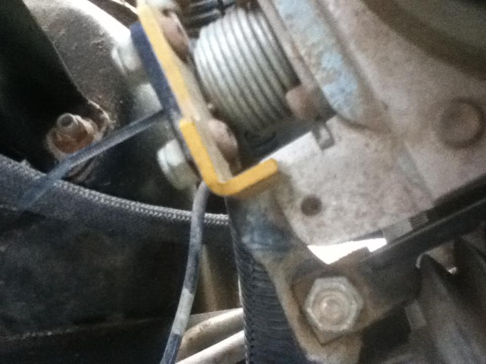

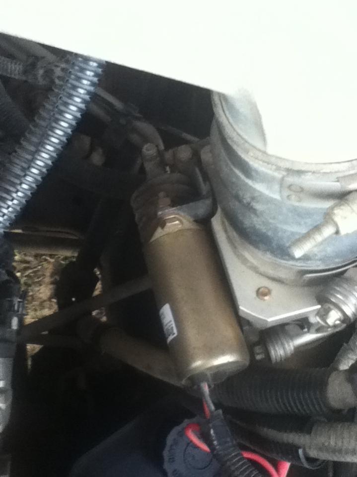

Okay.. Found my problem.. I have a cut off value at my intake manifold, found out i bump the actuator and it shut the valve.

So at the top of switch, I notice I was clean and looking at this and my hand bumped that shock looking thing which was spring loaded too a cut off on the intake. In that picture of the spring what is what kills the intake. So I had too rewind the spring so it could set on that plunger. And then it fired up again..

So i noticed this is like its a run away kill switch? or something...
