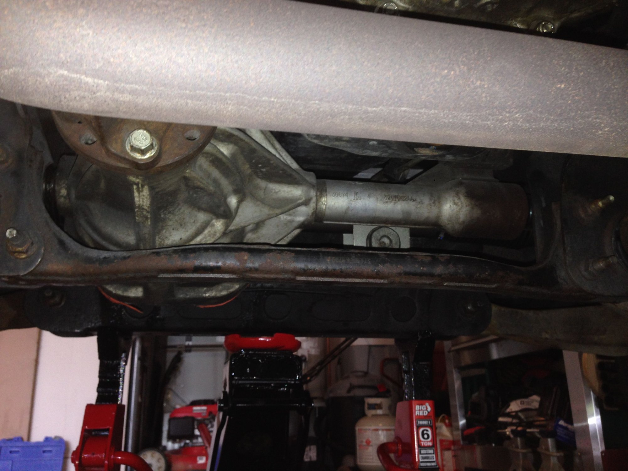

There is a crossmember running across the front suspension between the lower control arms. Specifically the lower control arm rear. Nothing obvious to the eye, but it turns out the bolts were loose on the driver side and it was binding on left turns and rear right turns with wheel at full crank. I will put a picture of the crossmember and bolts (upper and lower) and someone more chassis savvy than me can identify it for us. Does anyone know the correct torque for these bolts? I torqued them to 55 ft lbs and the clunk is now gone. Took it to 2 independent shops and the stealership and they couldn't find it, but they all wanted $$$ for new suspension parts

front suspension crossmember
Lower control arm rear bushing
