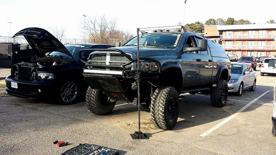

How old are the CVs? Yes limiting straps can stop this, but I'm on a 12" and this isn't even full droop but I've never had them pop off.
