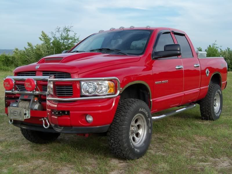

This is my old clunker I bought new in '04 and sold last year. Tires were 35x12.5x17 but the wheel will give you a good idea of what you are looking at. Mickey Thompson Classic IIs at 17x9 with -12 offset, 4.25" backspacing...

Well, you guys convinced me with those pictures, no lift so it will be a bit close I think, but I went for the Helo rims,
