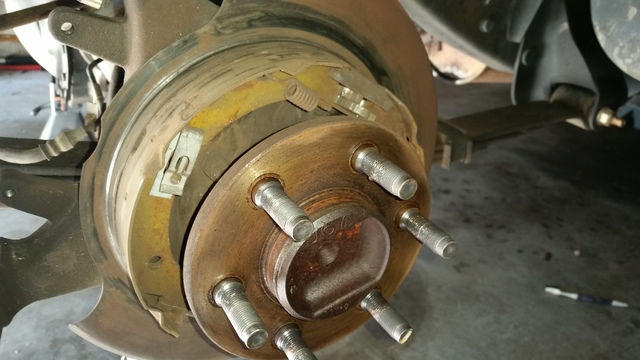

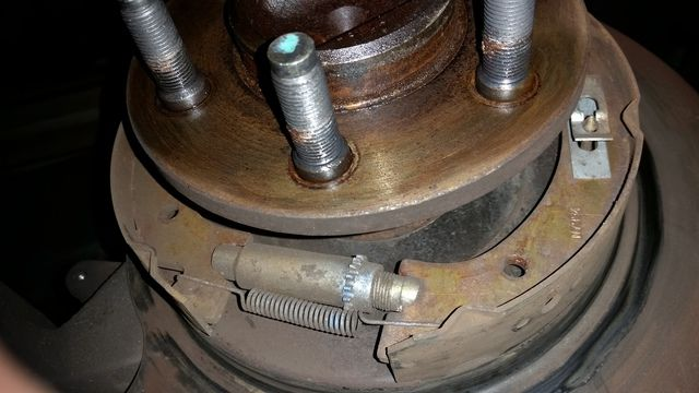

Originally Posted by R0ADHEAD
Last year I had to service the parking brake. Like any normal engineer would do... make it easy to service. Not Dodge! F*&king morons. So I had to pull both rear axles to get this done.
My 03' Dakota's SM said the same thing... pull the axles to replace parking brake shoes (the linings had fallen off the shoes, lol). I thought that was crazy and tried it without pulling them. It actually turned out to be quite easy. Not sure how your Ram is setup but if it's like the pics below, don't pull the axles next time.
https://dodgeforum.com/forum/2nd-gen...ne-soft-2.html
