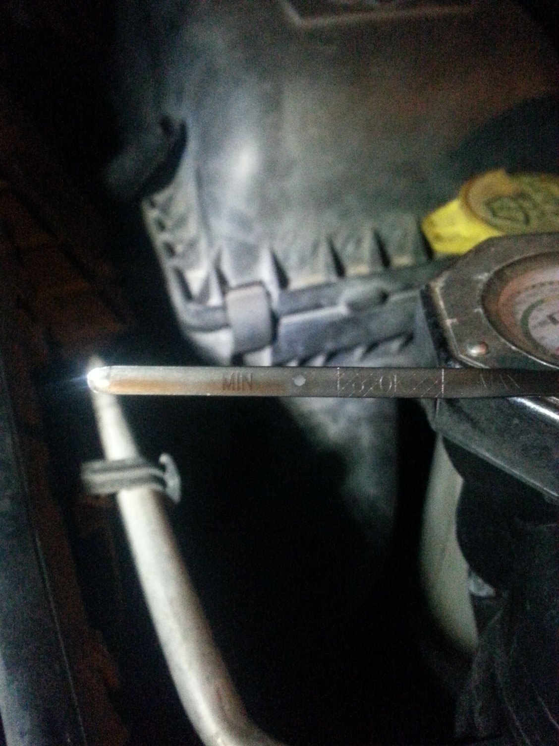

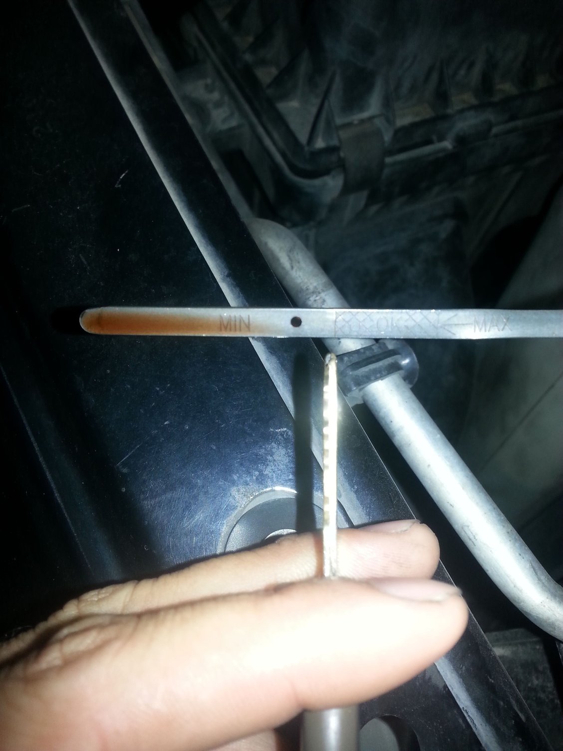

Hello and thank you for your reply. here is a picture of what the reading are on the dipstick cold, and warm.
WHEN HOT. right where my key is at the line.
when cold :
when hot
when cold

Fluid should be in the middle of the XXXXXX space. Looks a little low to me. Also looks a bit old. When was the last trans service?

Its low. Which can cause issues. Ditto on the trans service.

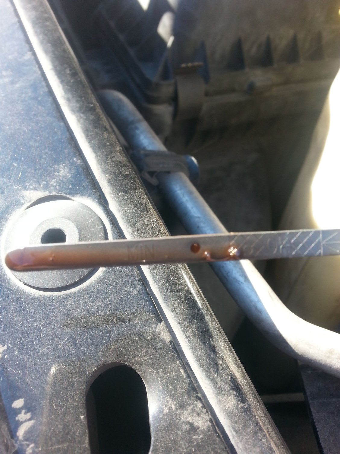

I added some more atf 4. Drove it around for about 20 miles and checked the level again. here is what i got.
checked while normal running temp. and in park while running
here is a double check of the level after the first one done this morning.
