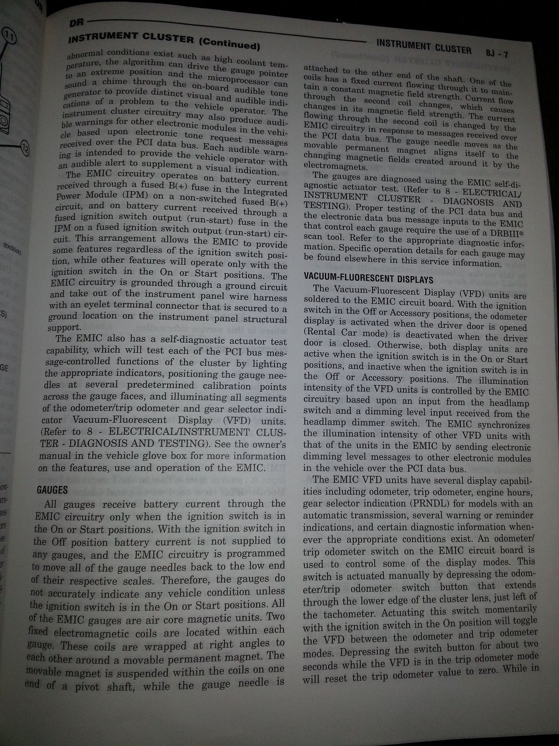

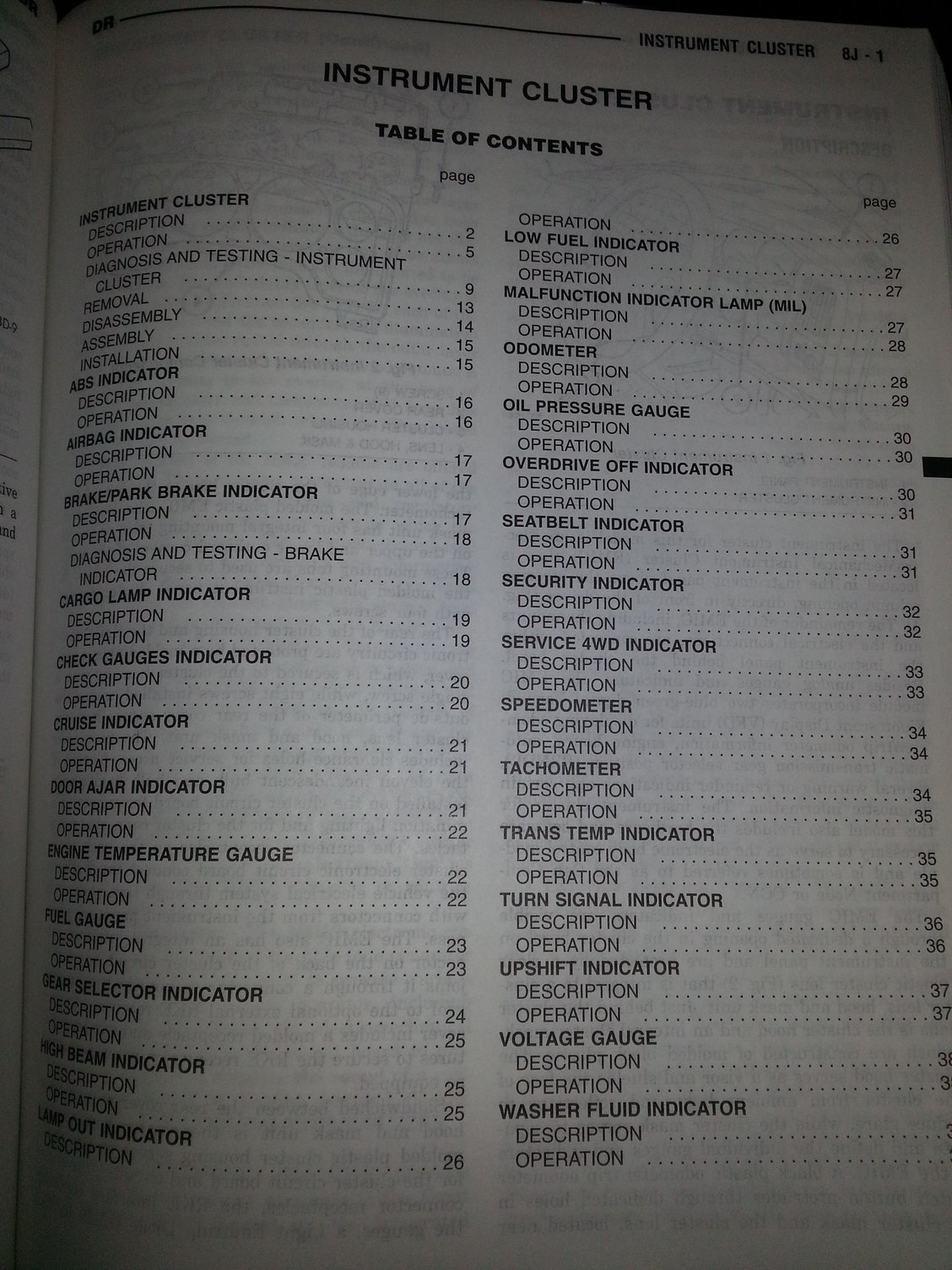

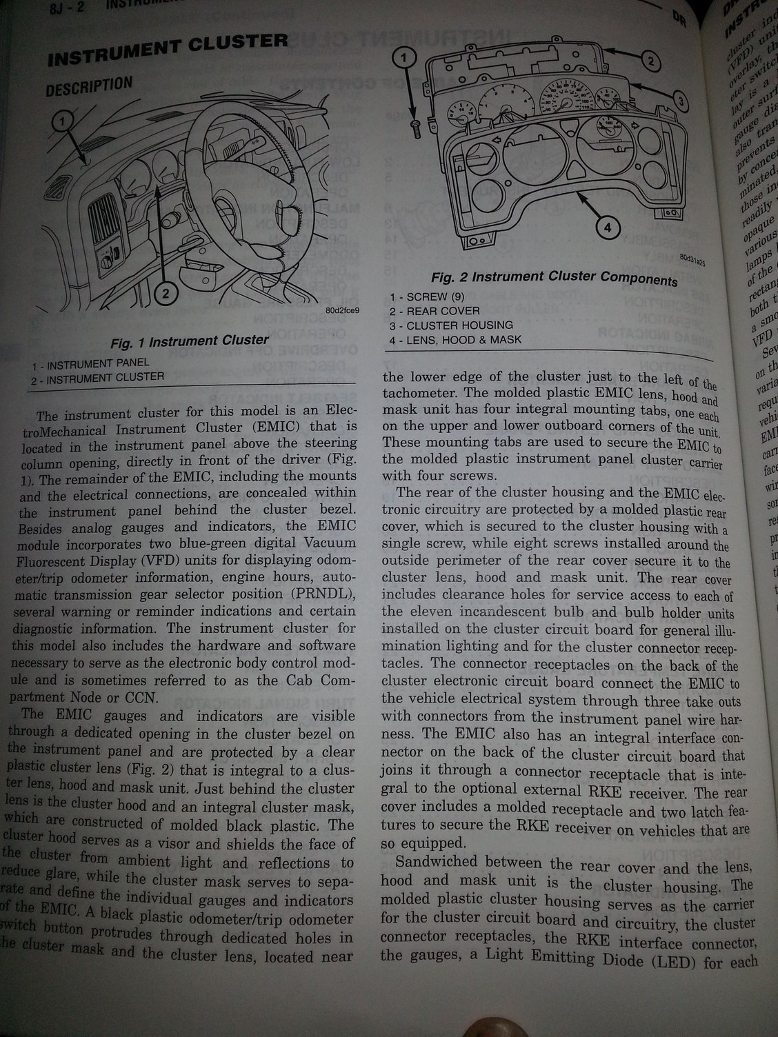

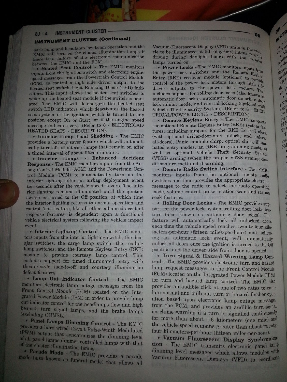

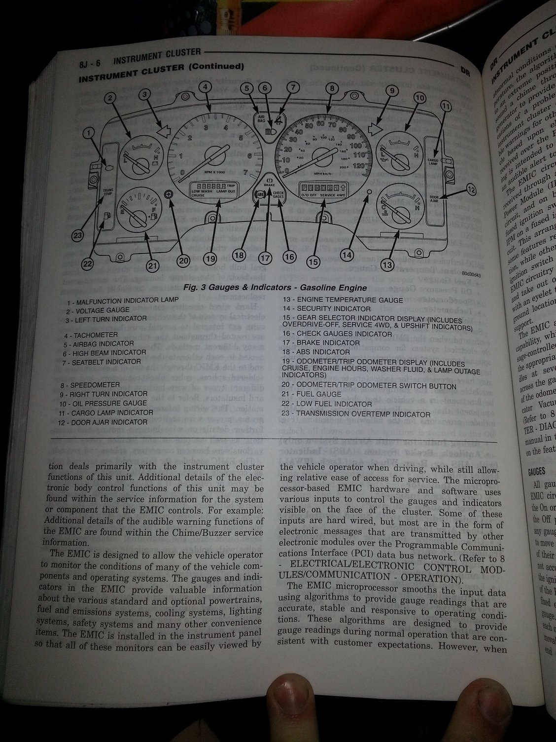

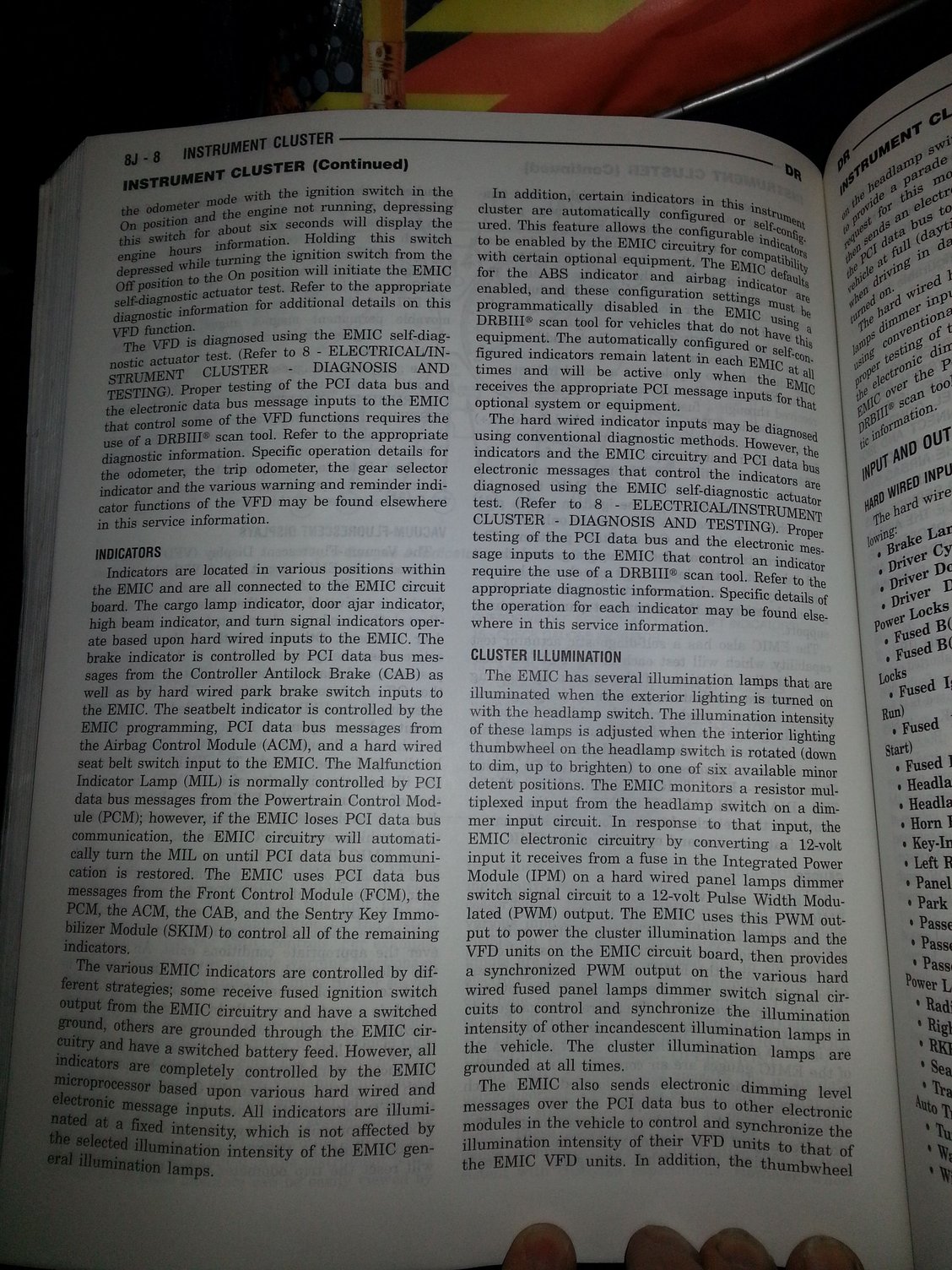

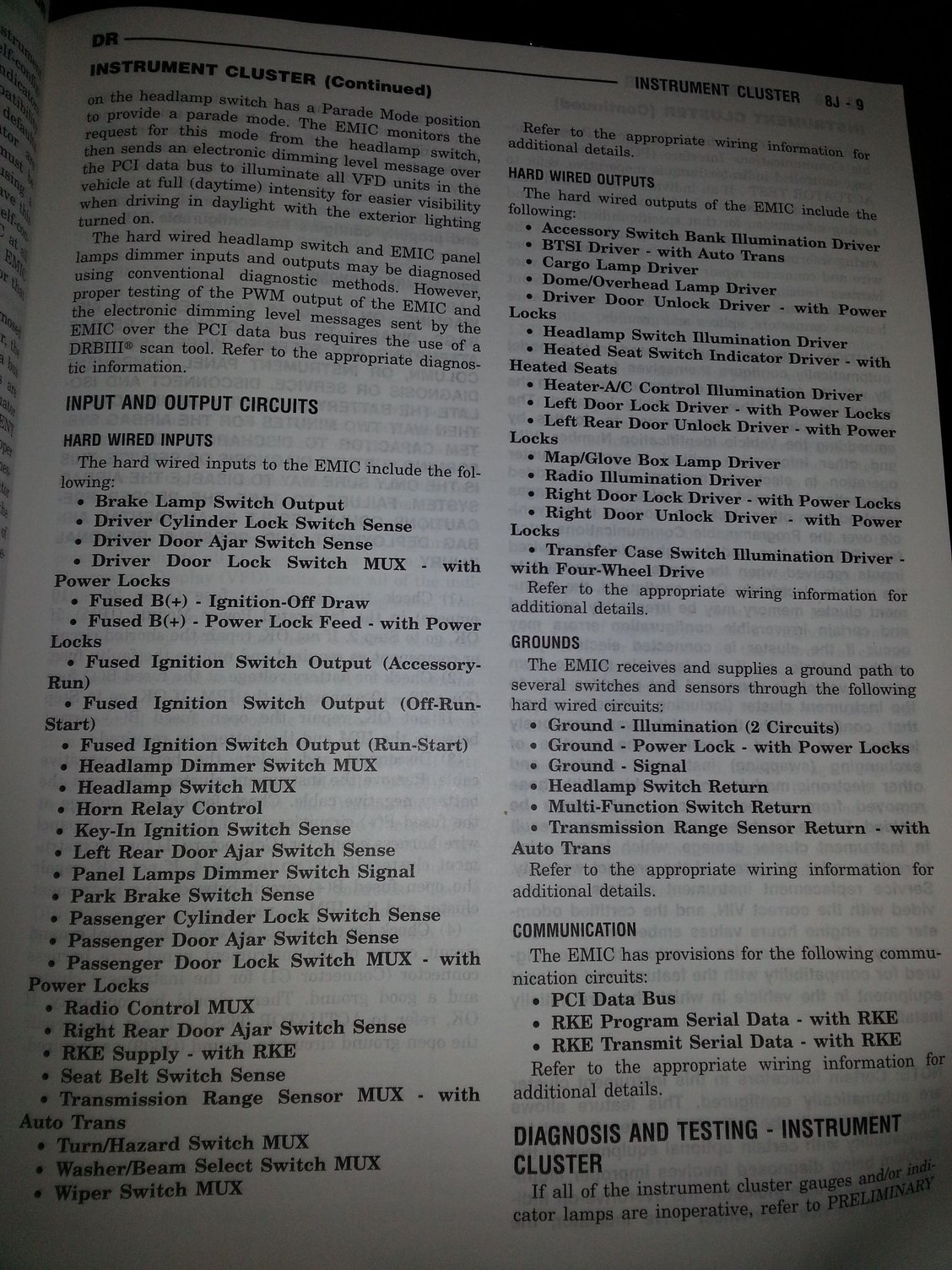

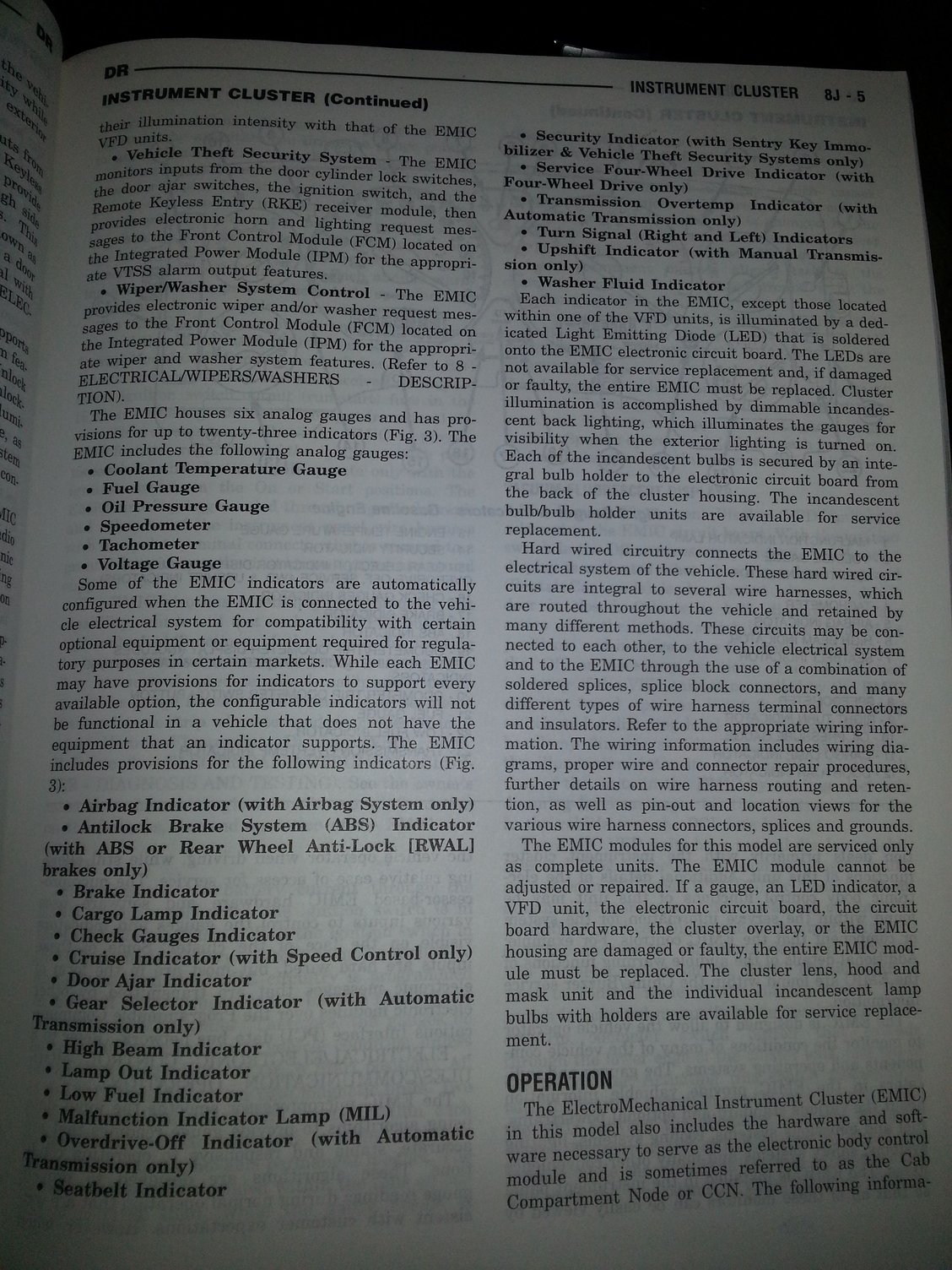

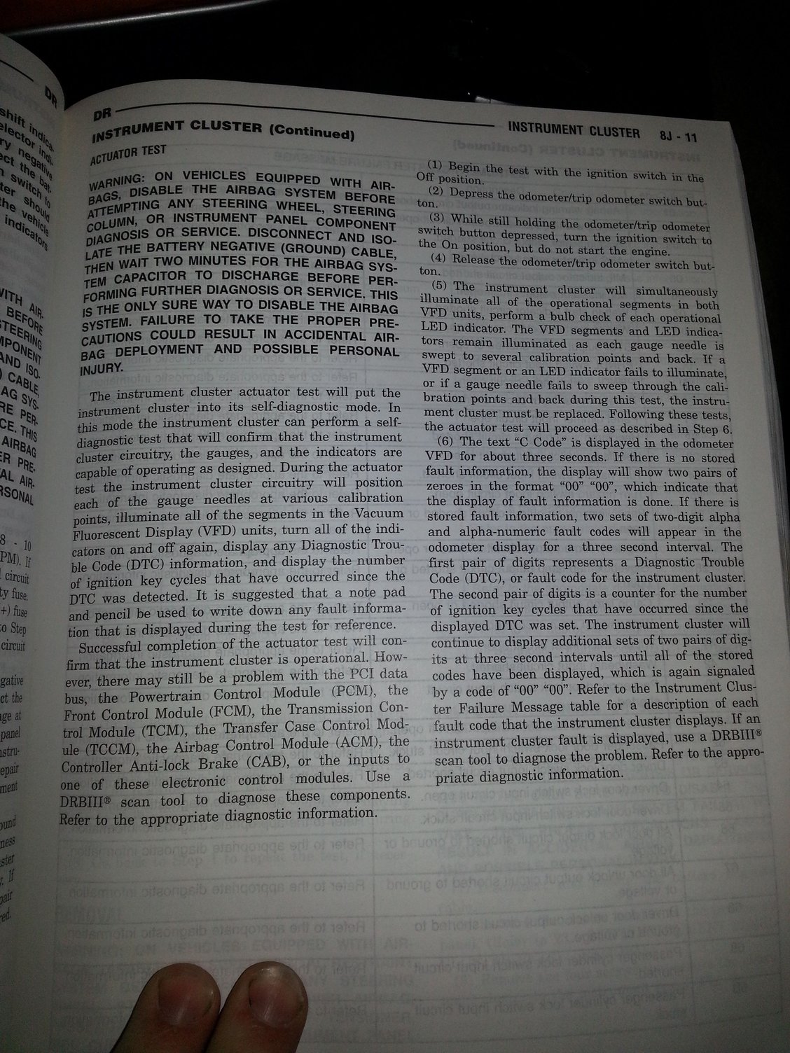

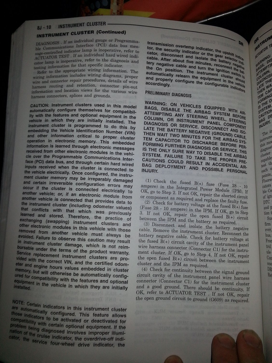

Finding not a lot of help here, I am sure you could use this. Took me a minute to get it uploaded. It is the basics of the instrument panel. This is out of a 2002 factory manual. This takes you through the preliminary procedures. Let me know if you need something more. PM me or something.
Here you go:

Ok thanks! Got that and a complete wiring diagram to the PCM. Going to start probing but first getting the truck in the garage as bad weather is coming. Thanks for the help!
