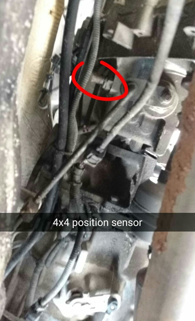

First off, let's get acquainted with the truck. This photo shows the 4x4 position sensor, but also the stock linkage:

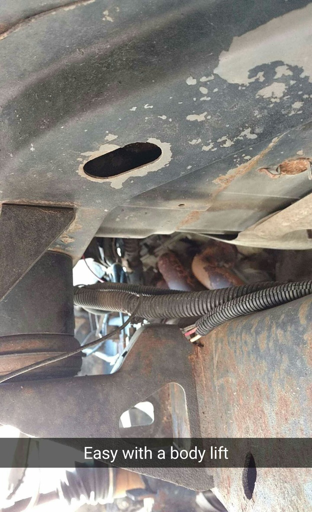

as stated, this will be easier with a bodylift.

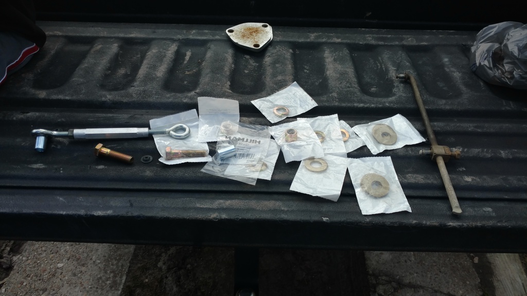

Here's the baggies of everything:

Reminder: Everyone change those 4x4 position sensors, they'll go bad and you'll no longer get that adorable little orange "4x4" in your cluster.
