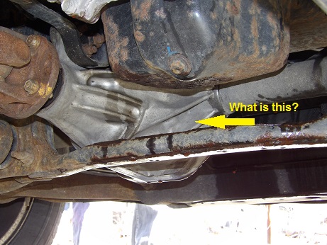

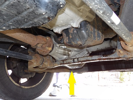

There's a lot of fluid in the driveway, and since it was driving ok I'm rather doubtful it's the power steering. Couldn't find much for diagrams online for the front end - so, on that note, can someone please identify the part where the arrow is on my pic (front differential??). The majority of fluid is dripping off of that, however it looks like there's streaks down the side of it so maybe it's running down from something higher? Thoughts? Could he have cracked a fluid line? Could the over filled oil somehow make the tranny dump fluid? Being this far forward and possibly higher up, it wouldn't be the tranny itself would it? I know some basic stuff about cars, have no idea about trucks as this one is my first.

If you have a lot of Red fluid, check the fluid level in the power steering pump. If its low or empty, that's should tell you what the issue is. Can't help but wonder though if your hubby may have hit a trans line with the pipe when he was whacking it around. Good luck and keep us updated!
