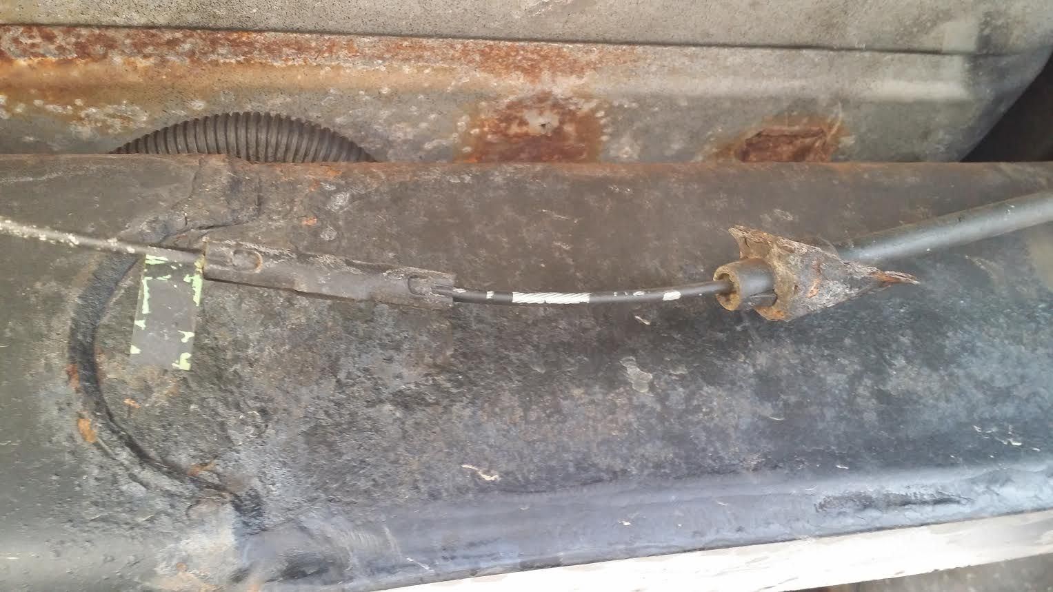

First would be the parking brake. It doesn't grab (at all), pedal goes down and when i use the release it doesn't release.
This is what it looks like right now. The tensioner was just hanging off the one loose wire on the right so i took it off as it was rattling when driving.
What do i need to fix this ? I've looked around but i haven't been able to find a DIY or example.
