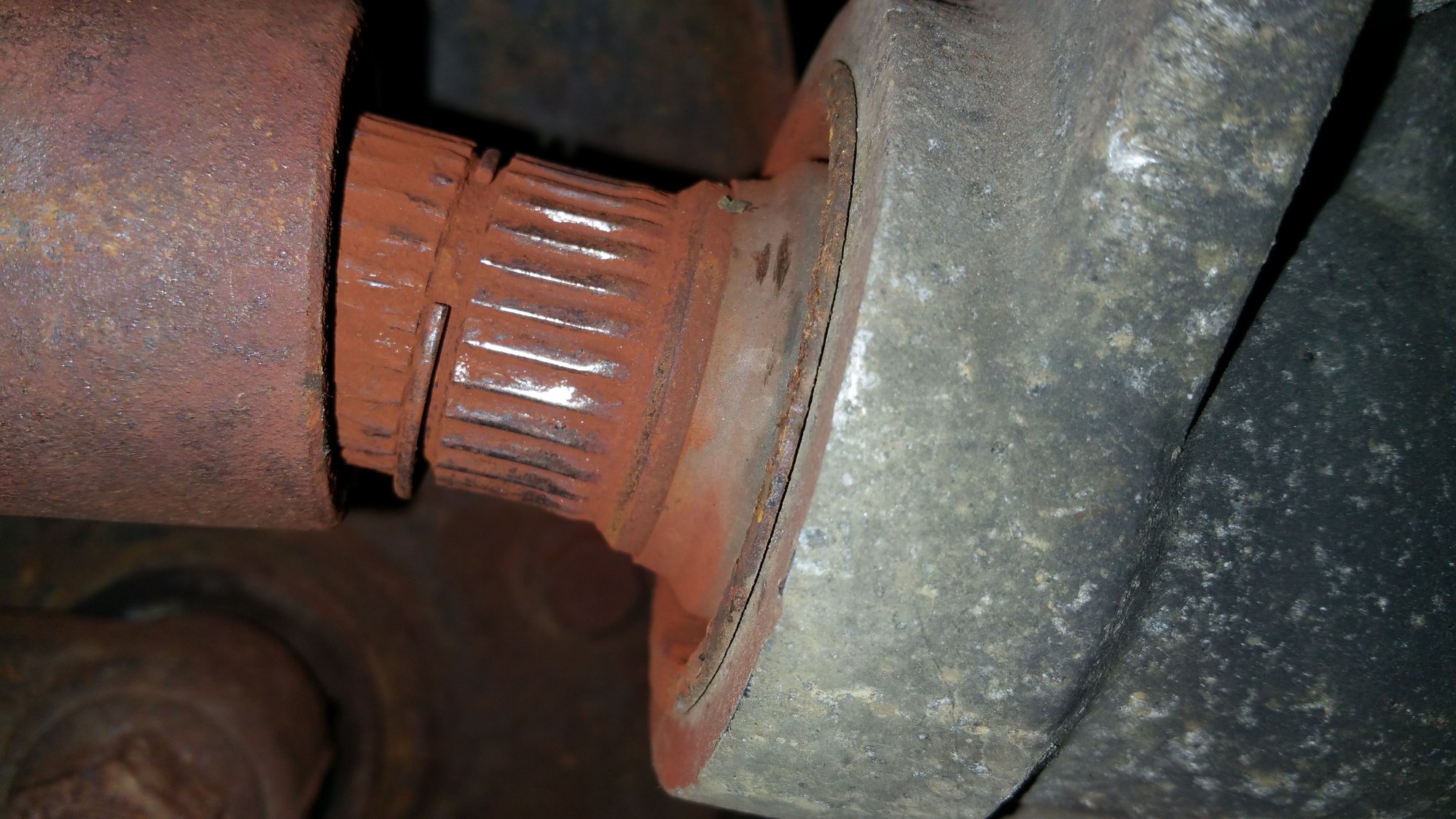

I ran out and snapped a picture. The CV axle is not pulled back as far as I can pull it but it is far enough to see some of the splines. You can see wear on them and a lot of rust. I am pretty sure they shouldn't be that rusty, I am guessing that means something isn't right.
rusty and worn, can't be a good sign

Usually the snap ring is the hold up. It should come right out. Bad outer seal will allow water and salt, and whatever else to get in there. Try a slide hammer.
