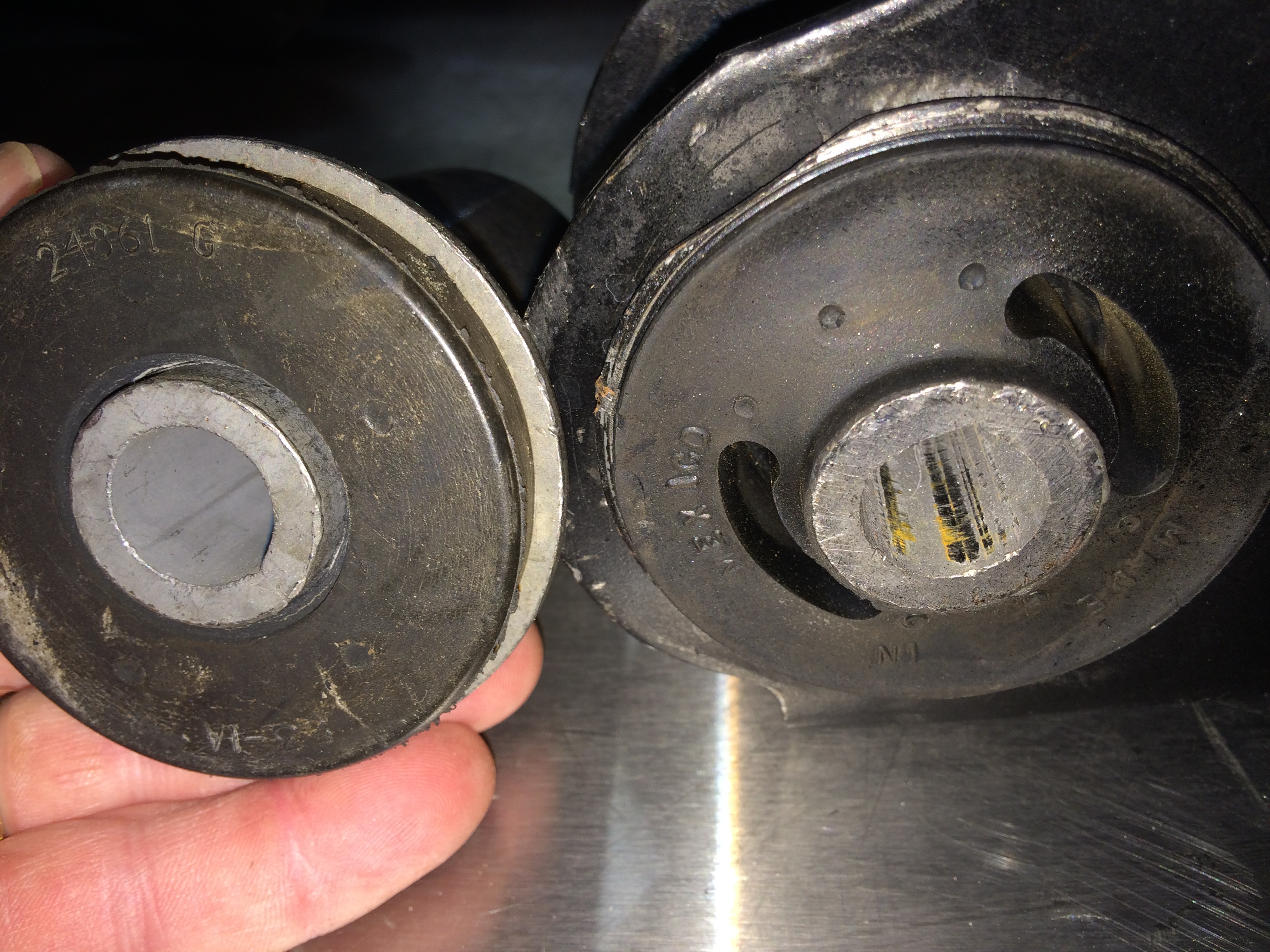

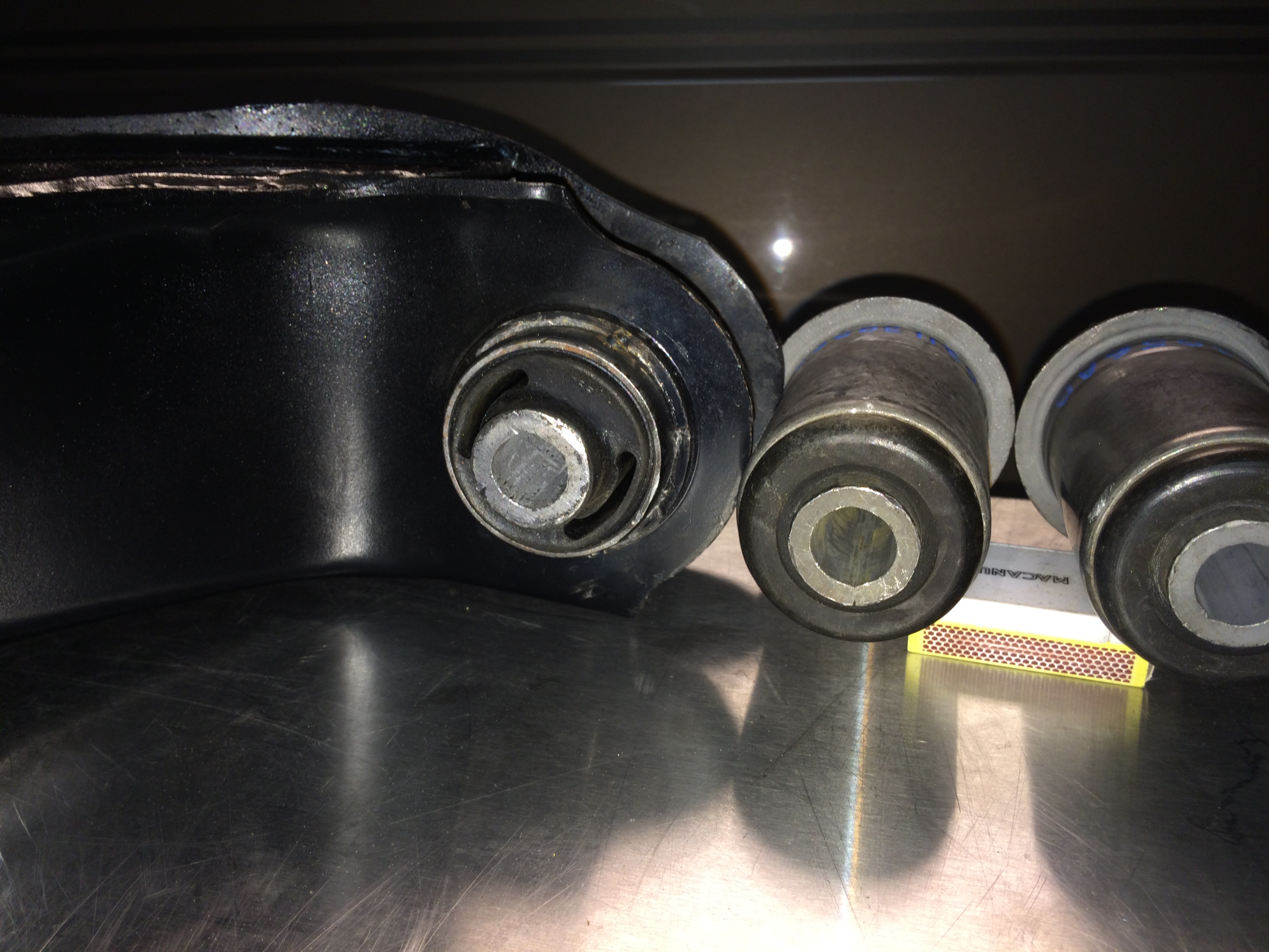

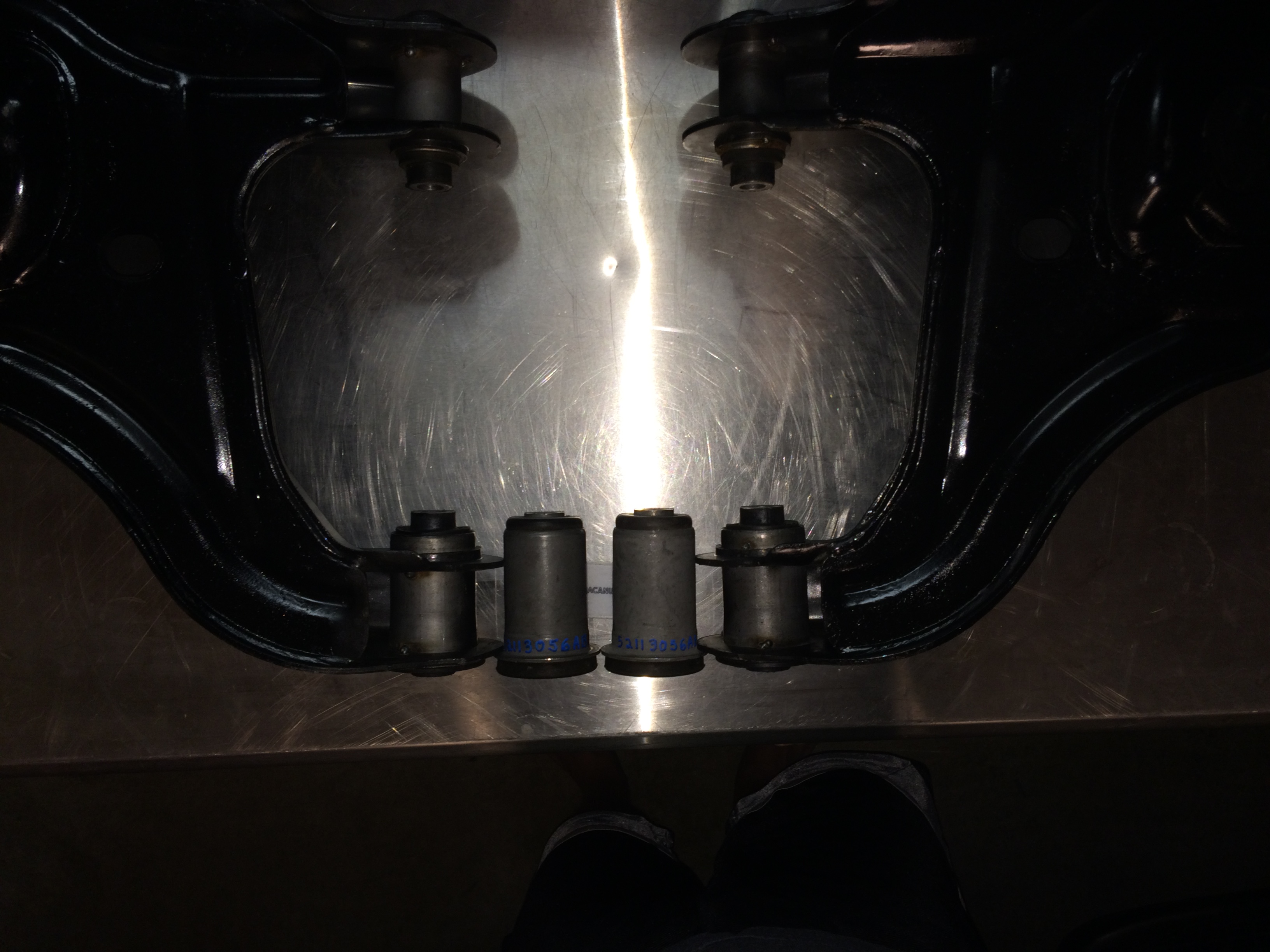

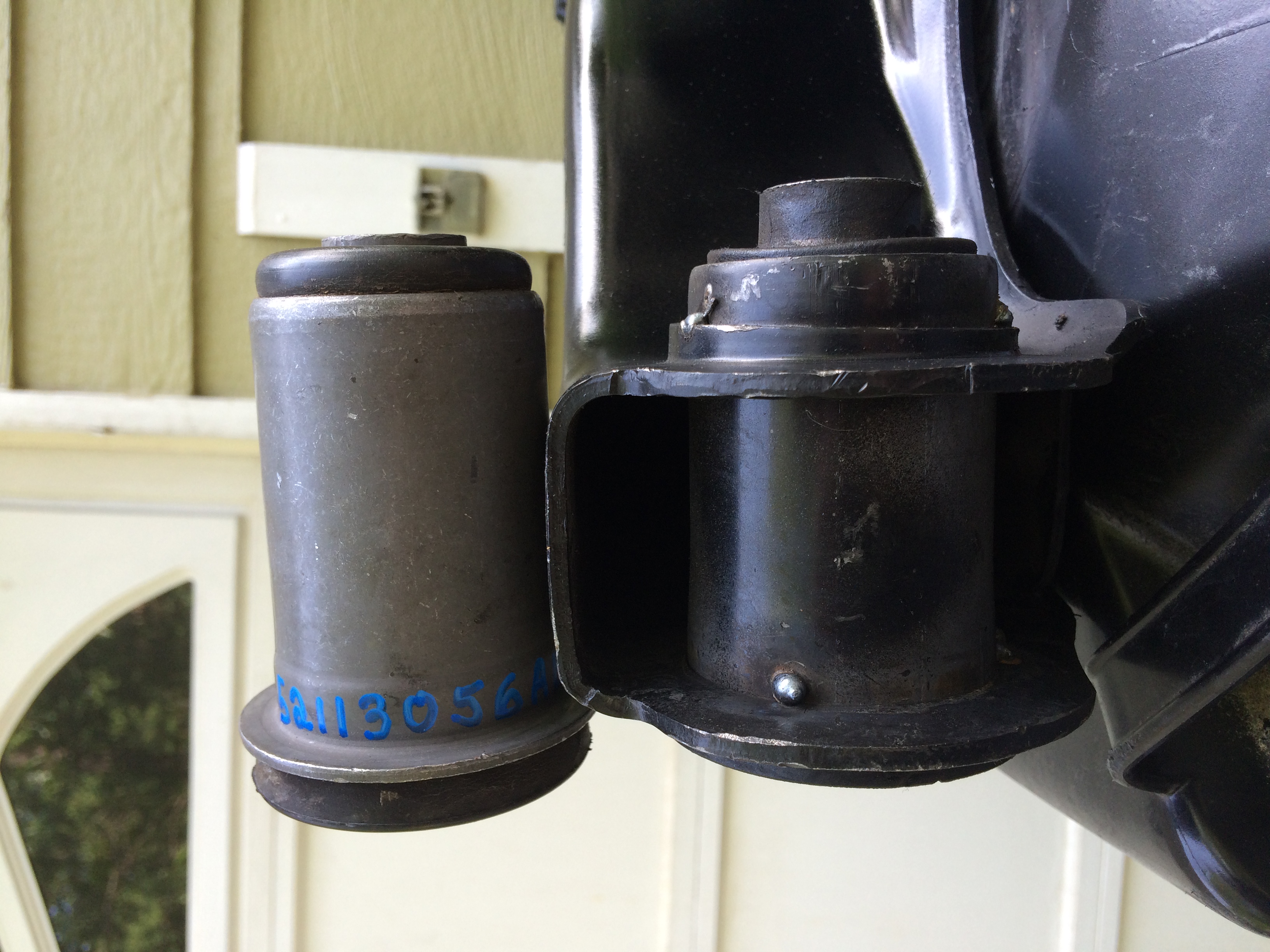

I think I figured it out! Hopefully!
According to Dodge my engine/trans combo is EZA which means 5.7 Liter manual trans HD. Dodge no longer sells rear LCA bushings for the 2500/3500 RWD lower control arms. The whole control arm is the only OEM option for $585 per side. Nope won't do it period. Truck will be crushed before spending that much for LCA's
I did manage to locate The part number for both the 2500 and 3500 diesel and gas with manual trans rear lowers. 52113056AB
The front lowers are 52113029AA respectfully. The aftermarket options for the 2500 with gas engine reflects the smaller light weight lower rear and due its location in the frame and lack of molded rubber on the ends causes the bushing to **** in its holder.
Yesterday I picked up the only 2 52113056AB's left in the state of GA
Attached are some pictures and comparison of whats supposed to be correct per NAPA for my truck (clearly not) and the OEM which is what belongs on my truck. I ordered the fronts which are still available from Dodge and due to arrive tomorrow. If this doesn't work then replacement truck for Grandpa.
See pictures in this reply of after market vs correct OEM lower rears.
