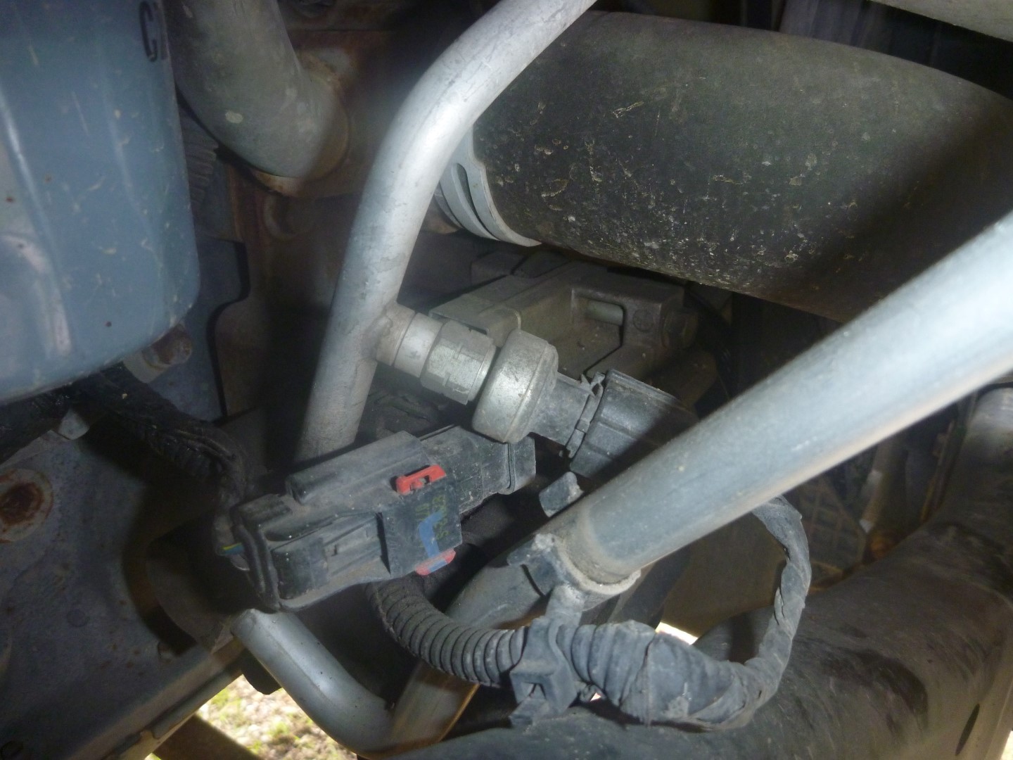

Im servicing a 2007 Ram 2500, 6.7 diesel. I see the low port side, but I do not see a port to attach my high pressure line. There is a sensor that plugs into the high pressure line, but how do I remove it to check the pressure?
uploaded a picture of the area im asking about.

Year? Engine?

2007, Cummins 6.7.
Uploaded a picture of the area im asking about.

There should be a servicing port somewhere else.

I'll follow the lines and see. Might be by the condenser?
Update: It was right under my chin Around the passenger side headlight.
