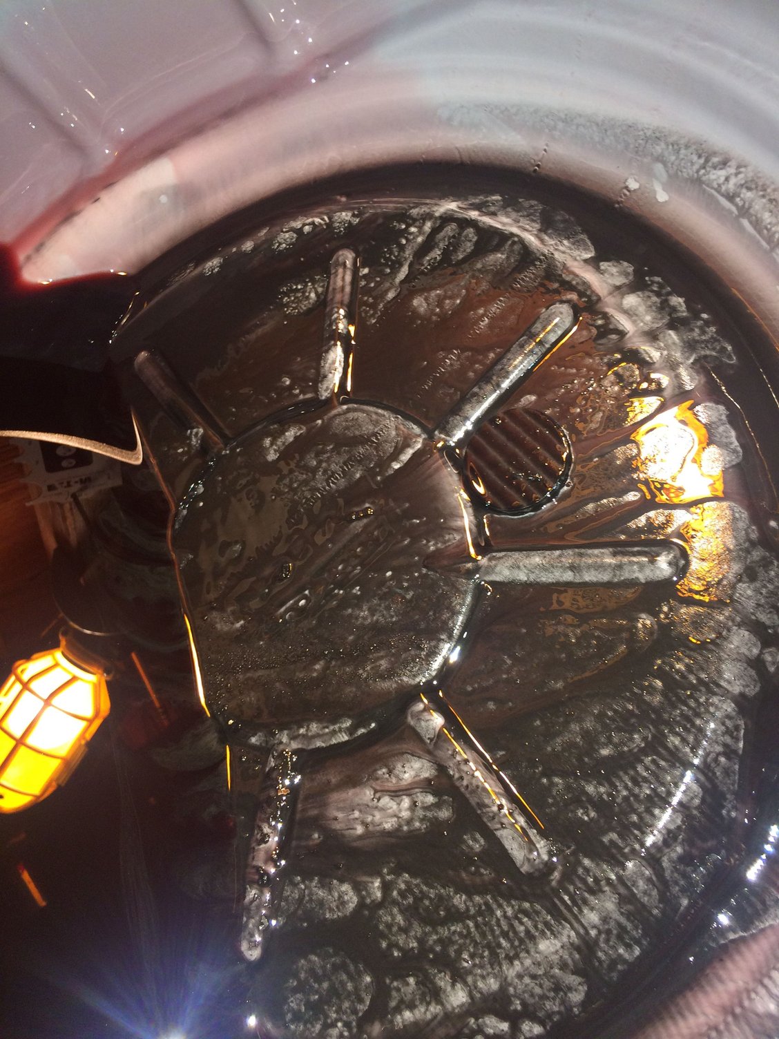

Yes there's appears to be a lot of material at the bottom of the pan. It doesn't really seem to be magnetic though. should it be?

Clutch materials non magnetic. I assume you took this when you changed the fluid. What does the fluid look like now. Dark? Bright red? Smell burnt?

Yeah I'm thinking all the material in the bottom of the pan is from the clutches. I changed the fluid about two weeks ago and haven't really driven the truck for much other than testing. The fluid looks kinda clean on the dipstick and it doesn't smell burnt like the fluid I drained out the first time. I guess I'll drain the pan again this weekend which is pretty easy now that I have one with a drain plug. I'll have another look at the accumulator plate and probably remove it to see what I find. I'll also try to test the solenoid with an ohm meter. I'm hoping I can eliminate some of the easier fixes first without guessing myself broke. I've replaced three sensors so far (Governor pressure transducer, Input and Output Speed) on the outside of the transmission hoping those would solve the problem and still no change. I've unhooked the battery too. My last option would be to either take it to a dealership or a transmission shop to see if they can diagnose the problem for me. To save some money and get some experience I think I'd like to do the work myself.
