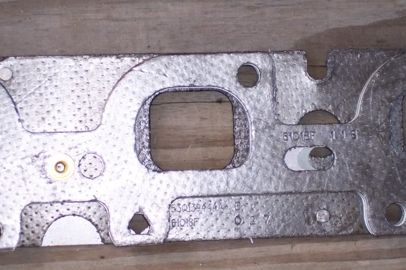

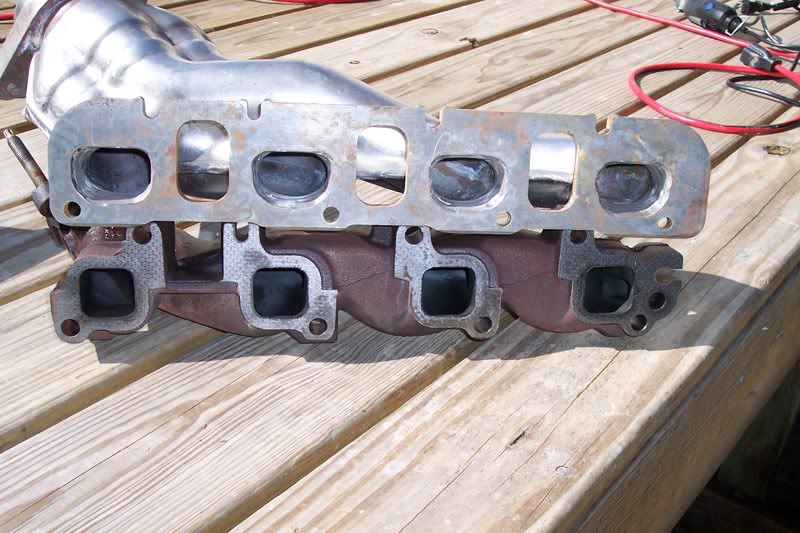

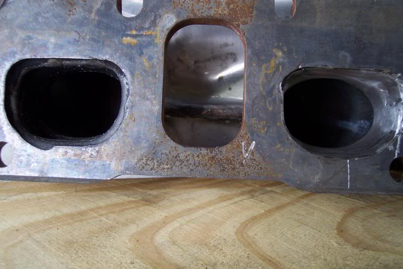

Getting to the install here next weekend found a complete exhaust set for $75 myself will be doing all the modding considering i have to use the 6.1 mid pipes and mod the EGR in the right/passenger exhaust manifold. right now porting the exhaust manifolds and working on the EGR.
