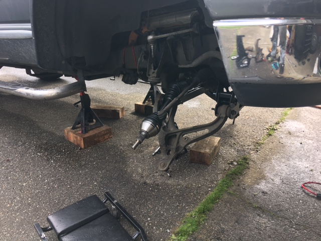

Finally installed lift
I got the Rough Country 4" lift installed, and let me say, get the Zone lift if you can. The instructions are crap as has been well noted in the past. I actually used the Zone instructions much of the time because they are identical in design. Before you give me the "Should have gone with the BDS or Skyjacker yada yada yada' it took a lot convincing the wife to let me spend the 1200 on this kit, let alone the 2k plus for the others. Its doesn't go together as good as Id hope but I made it work.

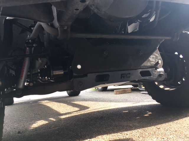

Couldn't get the stinger bars to reach the brackets, had to use some washers to close the gap(in sixth pic)
