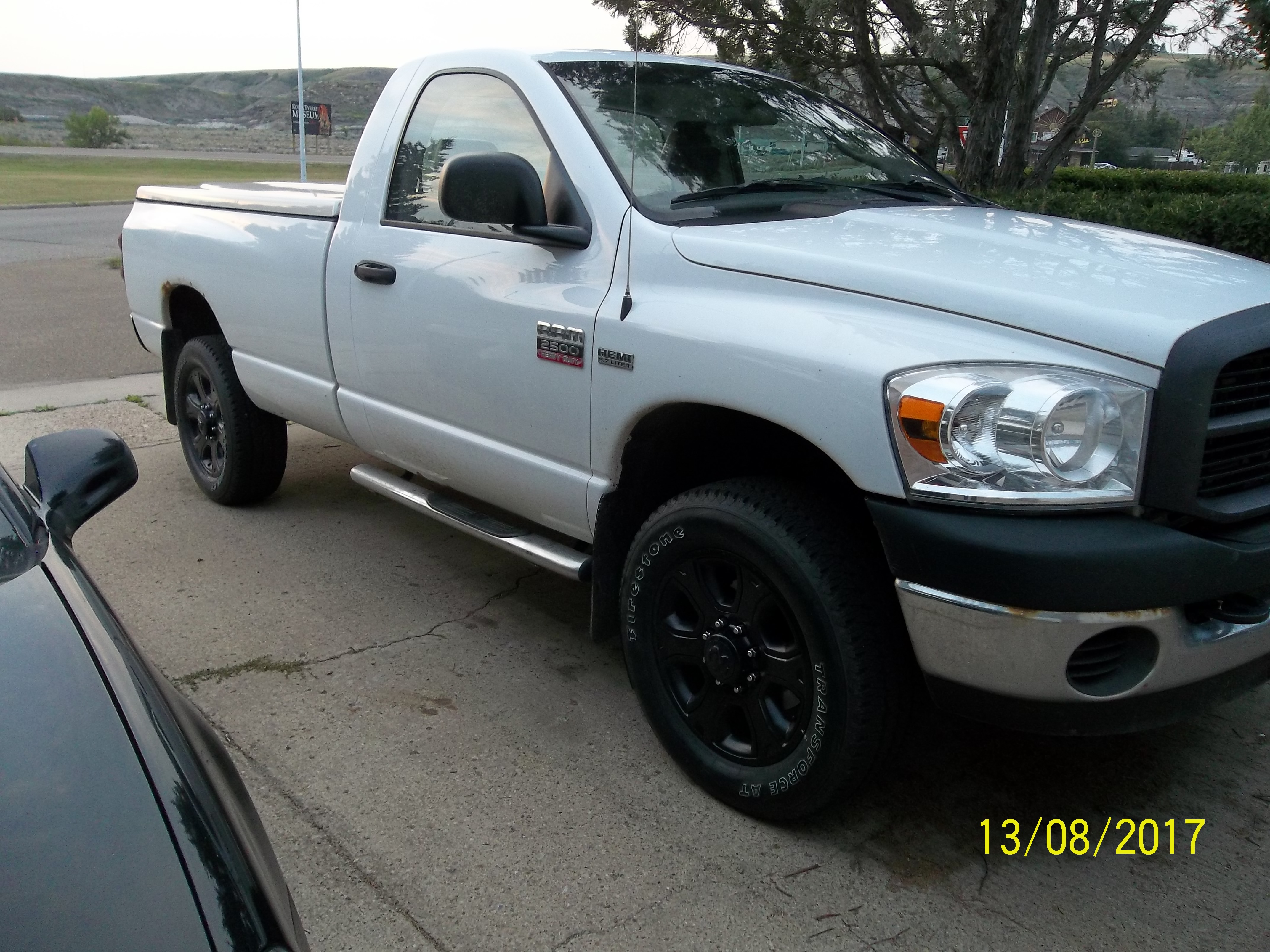

Default here is a pic
ended up getting a set of take off's from a 2017 ram...285/60/20 load range E...new tires, rims and tpms (which i removed) all for the price i would have paid for the 17" tires alone.
no clearance issues with the stock set up, vibration issues gone. reset the tire size in the tipm and the speedo is spot on.
