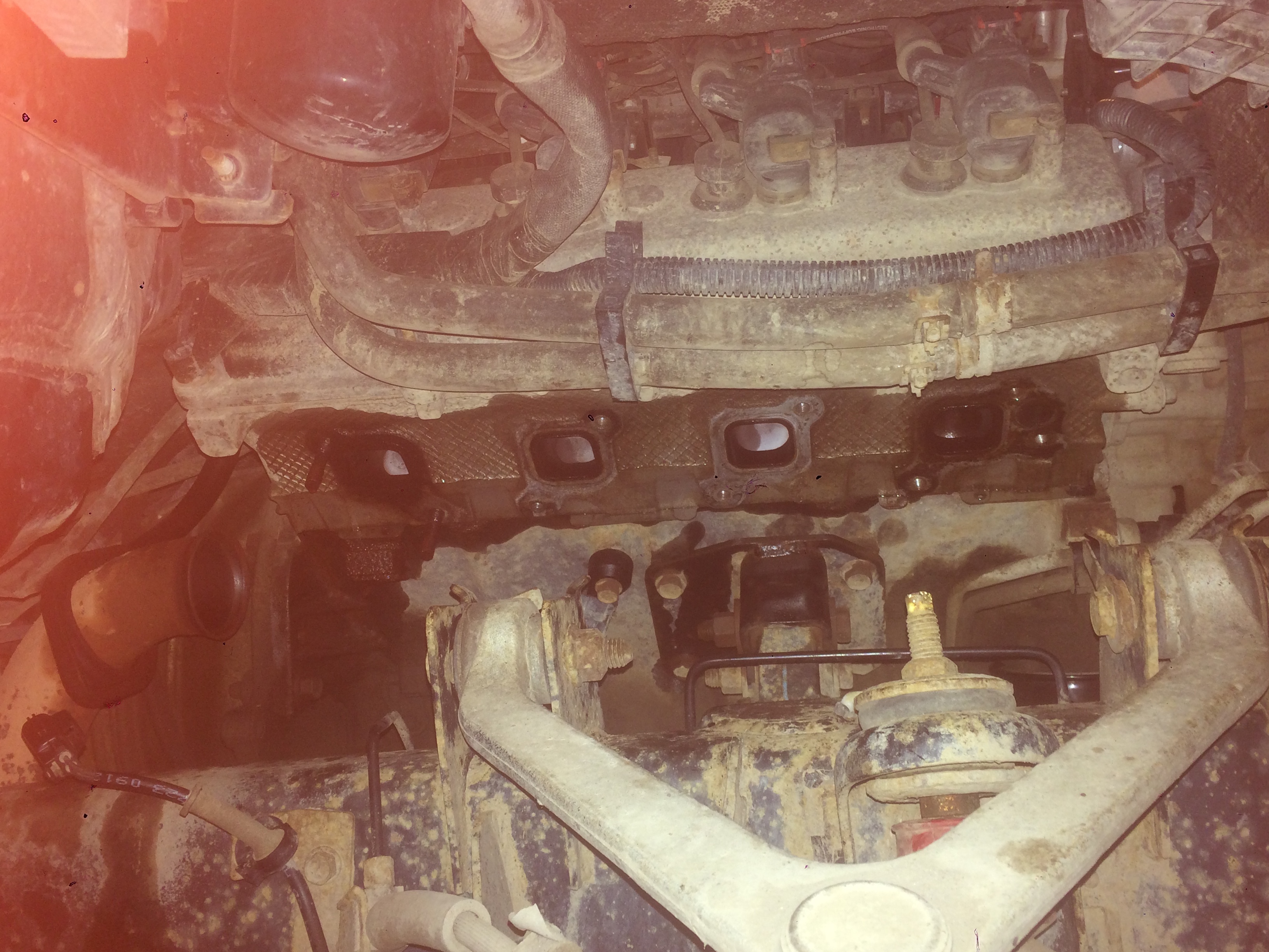

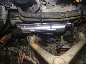

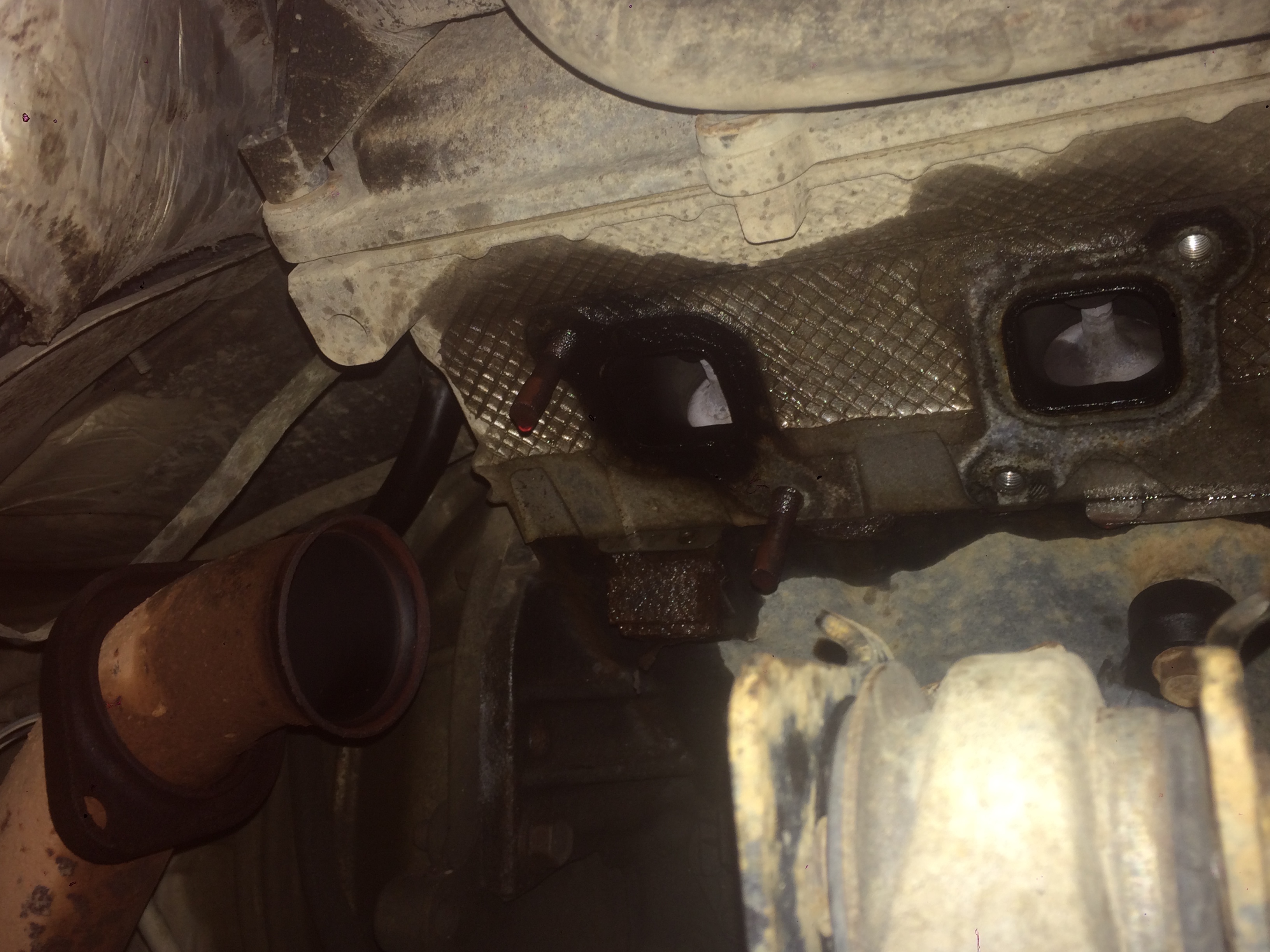

hello. I had broken exhaust manifold bolts on both sides of my 04 engine Hemi 5.7 and it was loud before but I figured was the bolts I fixed them up but truck still loud I know Hemi have the tick but what is it n can I fix it cuz mine is loud n makes my truck sound lik a diesel the fixed bolts helped a bit but rather have my truck sound nice. So any suggestions on what that might be wud b great thank u

Cracked manifold maybe. Did you closely inspect them before re-installing at the bolt change? Next in line is the exhaust flange joint. or a rusted exhaust pipe, holed through, . ....
Some mild noises and light top end ticking is normal, at least on mine it is. Sound source is injector squirts, valves, lifters, belt pulleys, fan clutch. There are alot of moving parts. Discern whether what you are hearing is just normal V8 churnings or if something is way out of sorts.

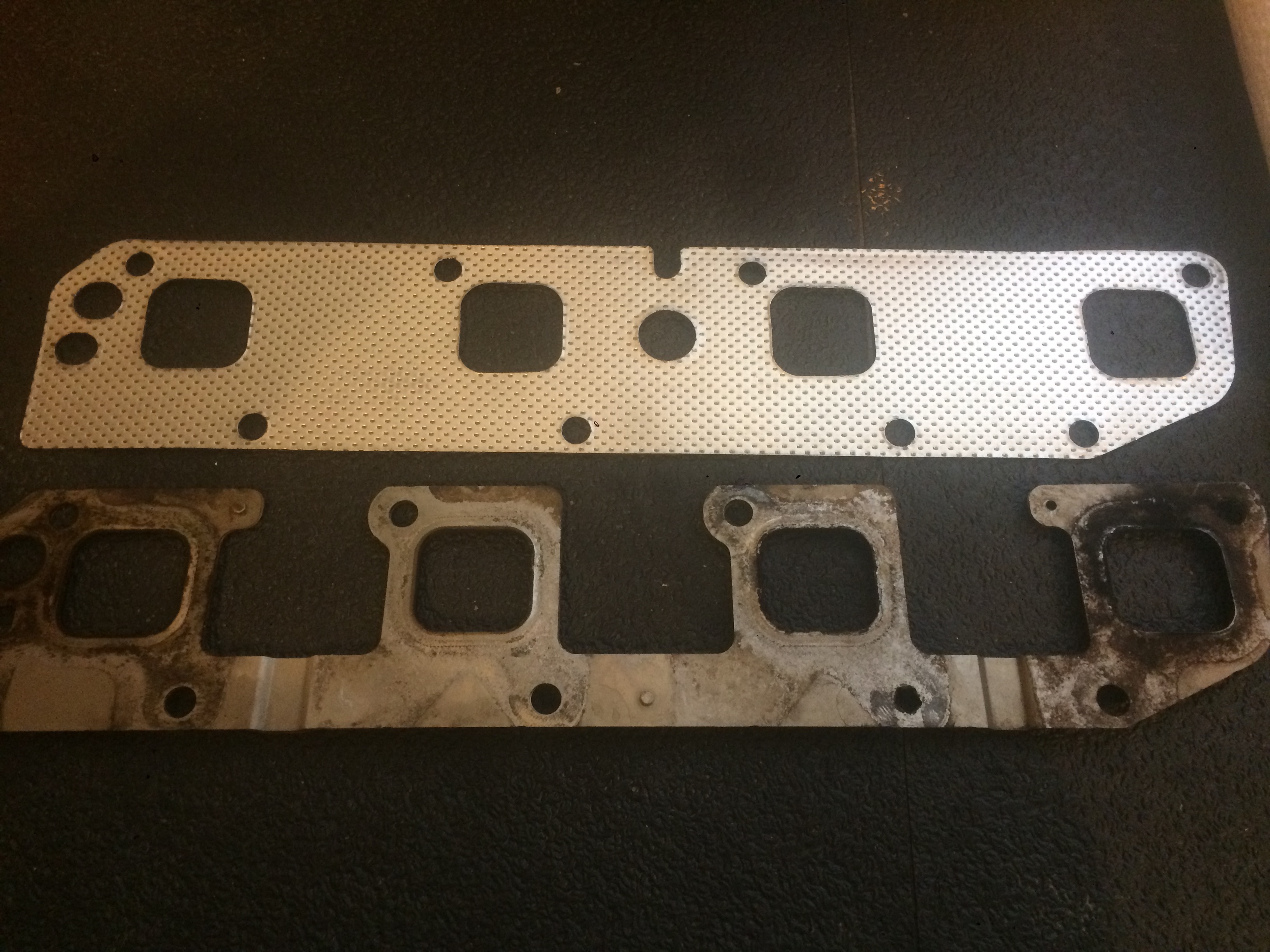

No I didn’t check it that well just a quick over for major holes I reused the gasket also but it wasn’t rusted out had sum soot from the exhaust leaking from the broken bolt so I cleaned n reused seemed okay. I will definitely go check it again and the flange it had a weird hole lik it was rusted out across the hole inside part but I was able to get it to pull together the manifold n pipe so if that’s rusted that wud make that noise?

Suggest you redo the job, inspect, and ensure to install NEW gaskets. The gasket is your most likely problem based on your last post. Never re-use the gaskets.
I recommend Fel Pro for reasoned cost. Or go oem Mopar if you are a gotta pay 4x the price kinda guy.
