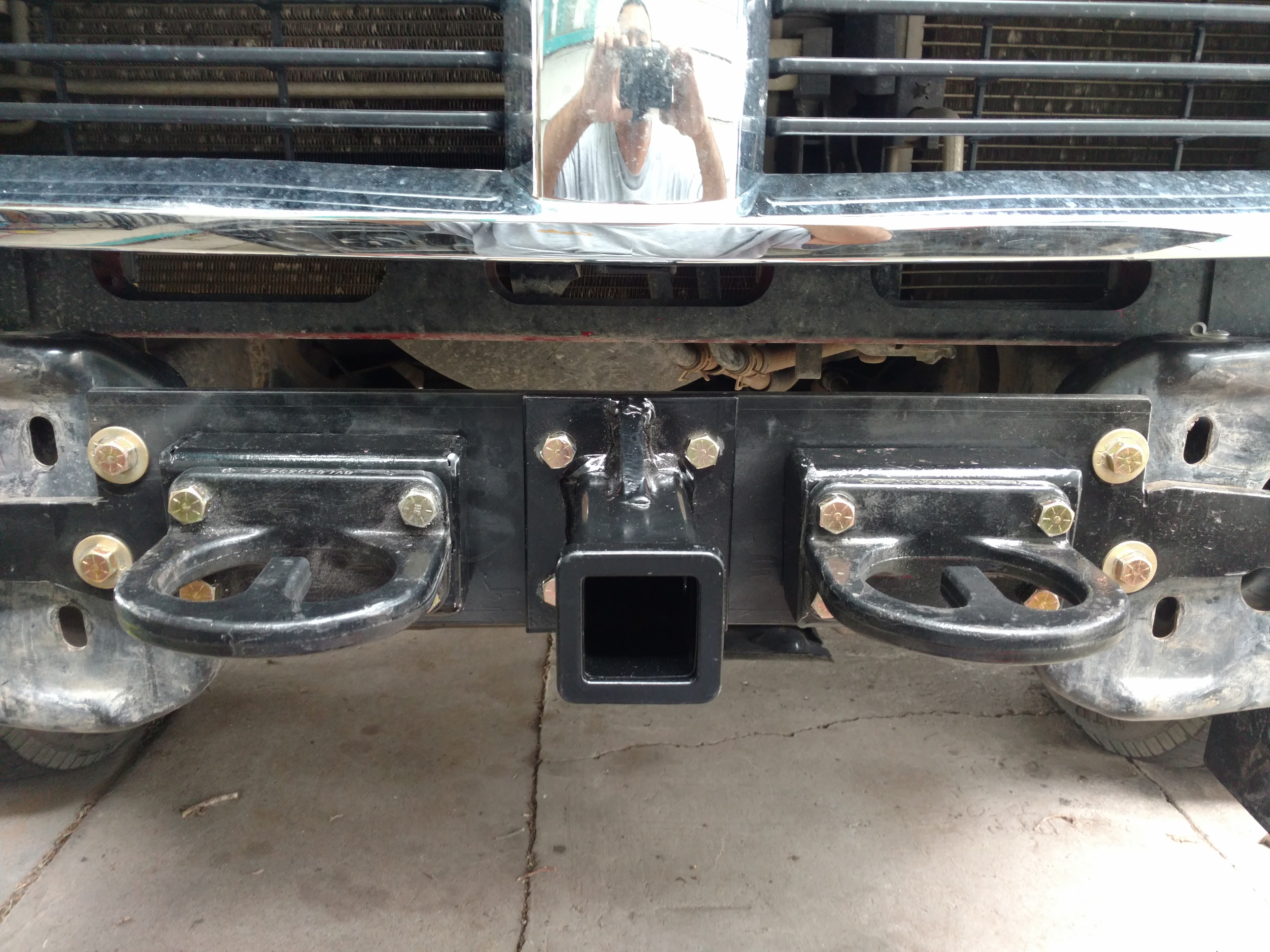

I got a 6in x 3 1/2 foot 1/2in plate steel. I was able to make a cardboard template of the mounting area and cut my piece to fit. It appears the 06-08? bumper brackets cover over the tow hook mounts. In the earlier years, it is open. So I had to make sure the shape of my tow hook cross-member cleared within the bumper bracket slots.
I got the tow hooks from a local junkyard for $40 for the pair. I lined them up and drilled the holes and bolted it up with 1/2 grade 8 bolts.
I thought a front tow hook would be a great addition since I have the strength with my cross-member.
I ordered a receiver hitch that bolt in place for a pintle hook since it can bolt up the way I need.
To fit the head of the hitch through the bumper slot, I had to bend down the inner lip.
https://www.etrailer.com/Hitch-Fabri...371804055.html
Here is the 1/2 cross member installed and the how hooks installed.

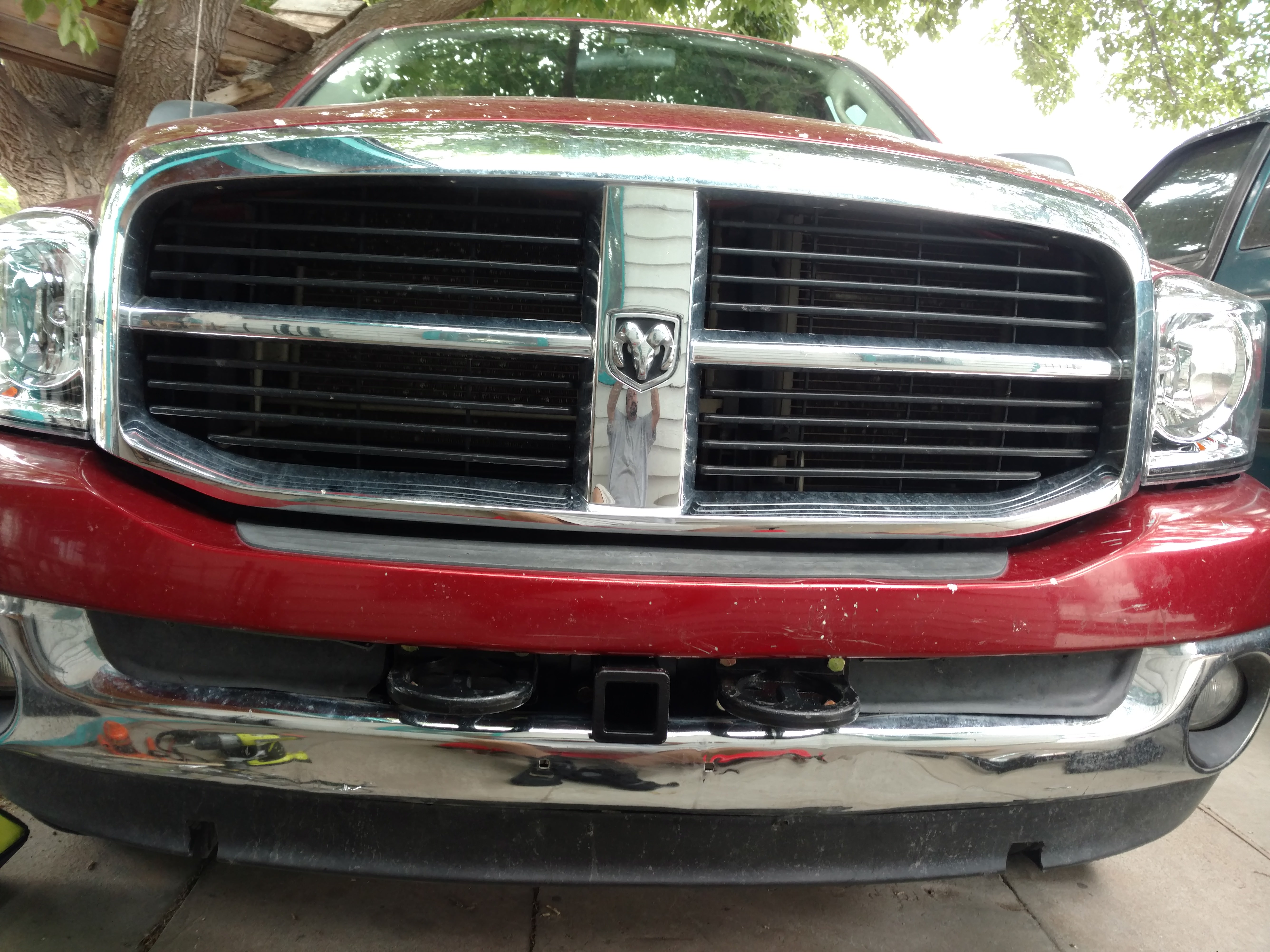

After installing the bumper, I didn't like how short the tow hooks were.
So I decided to build some spacers for the tow hooks out of 1/4 wall 2in tubing.
Here is the final install

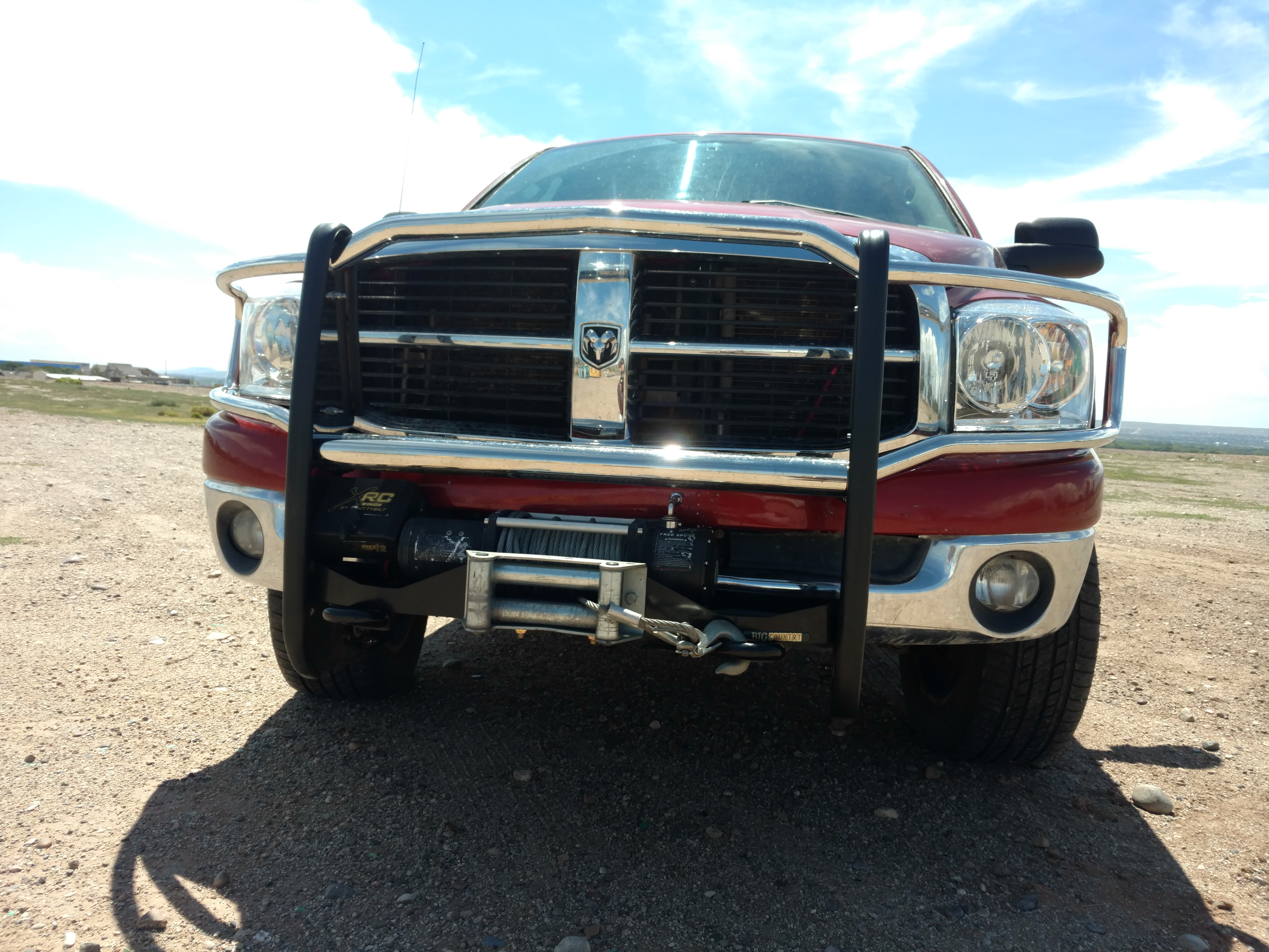

Well as an update,
I bought a Big Country (Made by Go Rhino) Grille Guard with a winch mount. I rather have the black powder coated version, but that was a good $300 more, (I'm not too big on chrome). I installed my Smittybilt XRC12 winch on it. I moved up the winch tray about 2-3 inches. To reinforce the winch plate I made a bracket using 1/2in steel plate, which ties the winch mount into the 1/2in thick tow hook bracket I previously made. Now the winch mount is EXTRA strong. So I had to remove the front hitch, and since the winch now covers the Mopar Tow Hooks I installed, I bought some tow hooks/loops from a 2000 Ford F250 and mounted them below the winch plate.
