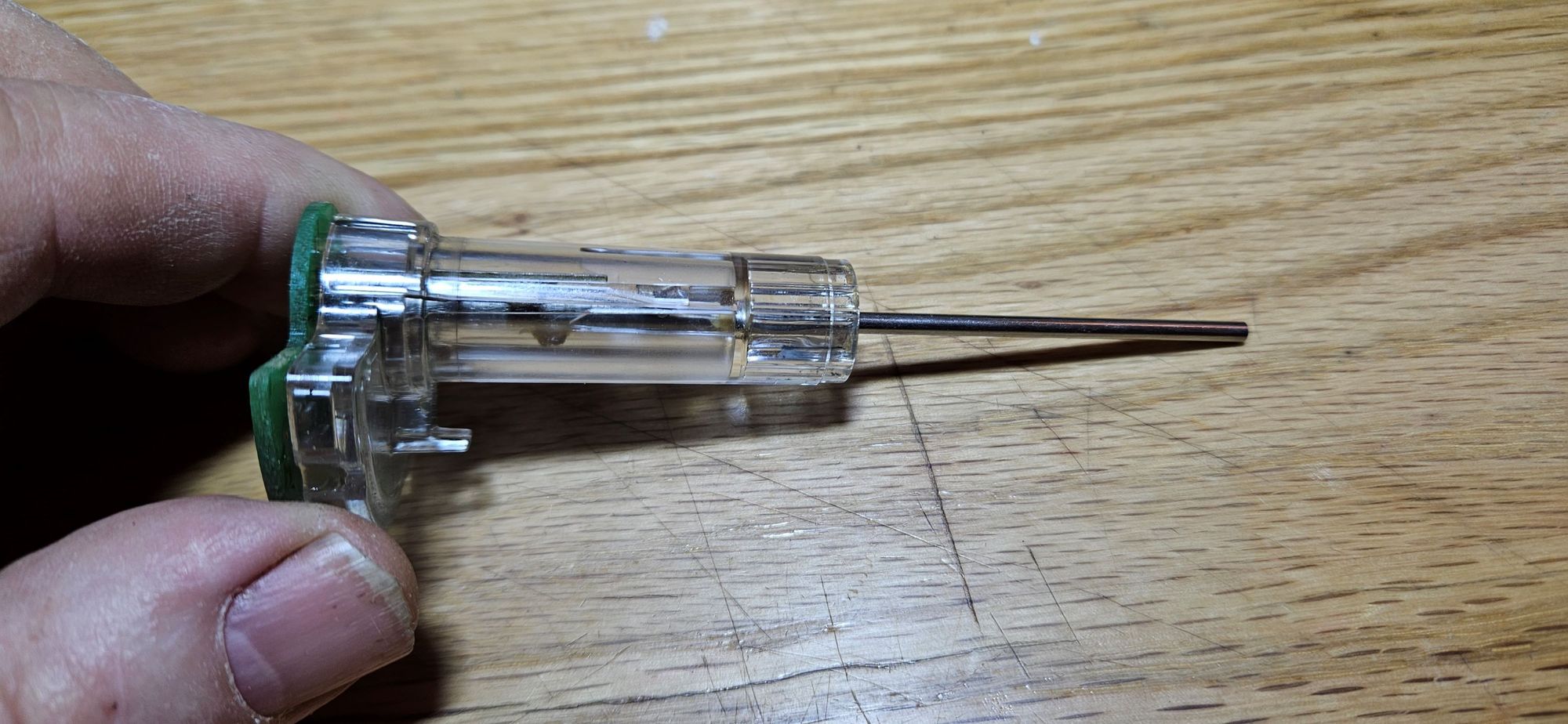

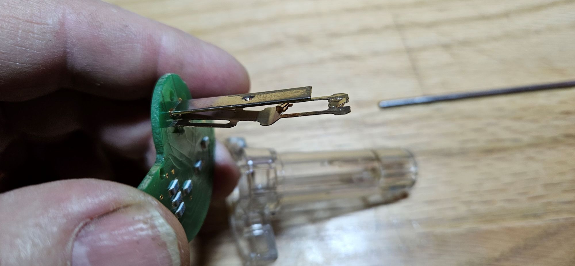

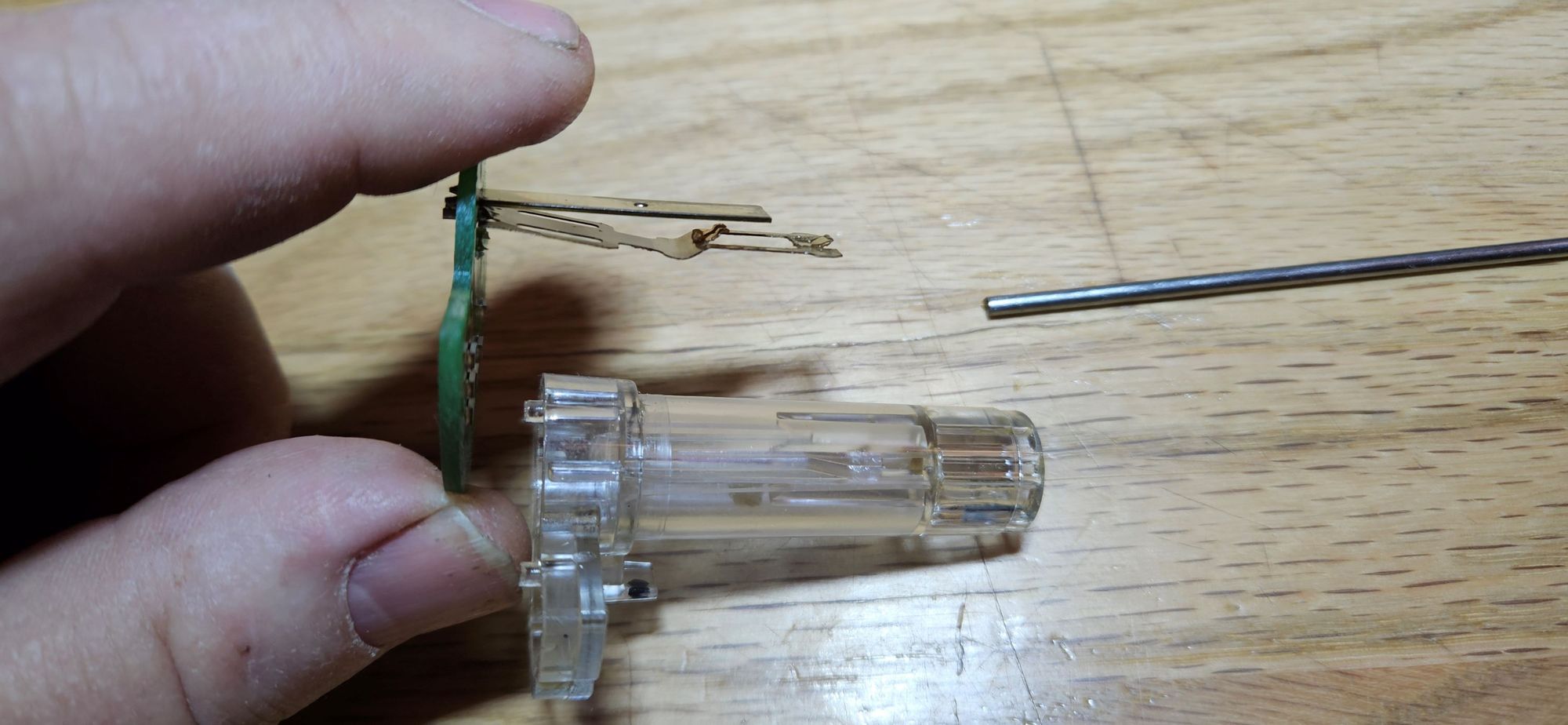

So, I took the OLD switch apart, SHOCKER!
It's nothing more than a bunch of Variable Resistors, (Rheostats/Potentiometers)
If it costed, HUNDREDS, it might be worth just cleaning and trying it again.
UPDATE:
After taking Ignition Sw apart more; I feel it was the long shaft part, that was the problem, see Below.
There is a long PIN that come out from the Key Tumbler device, (Simulated below), that slides UNDER the switch and pushes the contacts up to make a connection.
It slides in and out and ACTIVATES a SWITCH in the long shaft area.
I can't prove it, but it sure lookes like the METAL was Exanding (bending) and Contracting with HEAT (of Cold).
Unless it's a COLD solder joint on the Wiper side, I'll bet it METAL EXPANTION.
But, just $50 bucks for a RELIABLE FIX, it's worth replacing.
