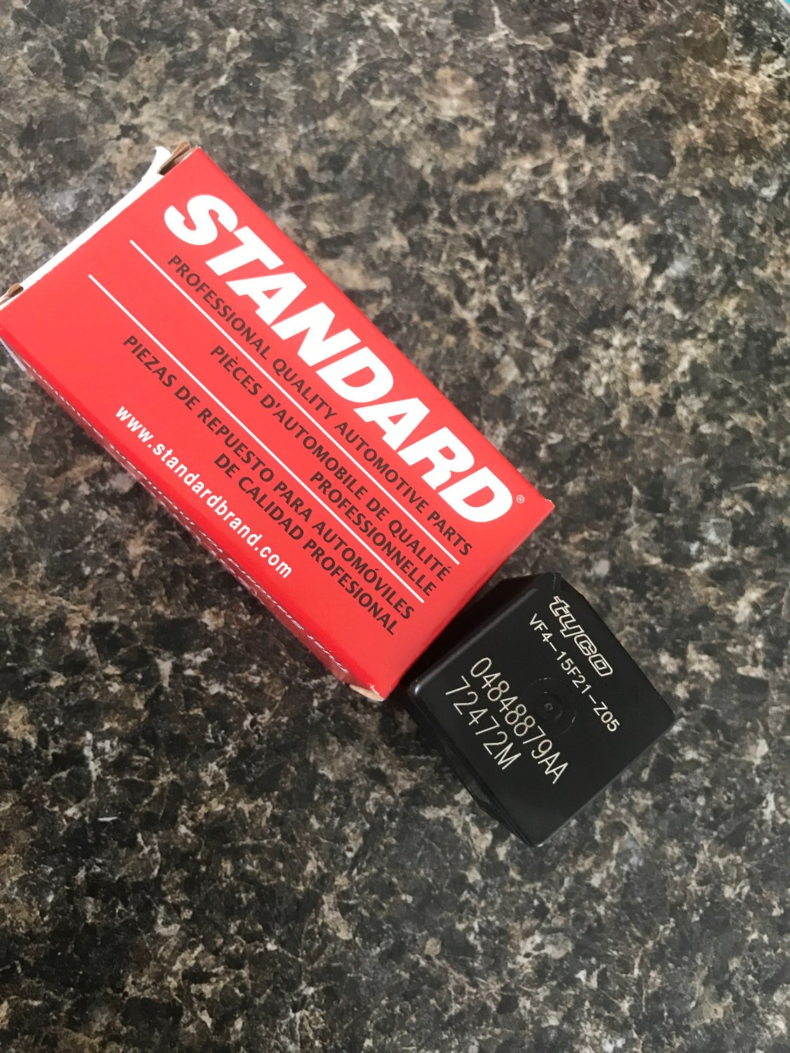

Default Eureka!
Originally Posted by SnowBeast428
To me it sounds like a computer or starter solenoid/relay issue. I'd check that as it sounds like its getting power then the computer shuts it off likely due to sensing an error.
Thank you snow beast! I think the starter relay was the issue. I will update you guys tomorrow to help anyone else with this issue out. I replaced it for $10. Put the key in and held it on the forward position and I could actually hear it continue to spin. So pretty cheap and simple fix.
