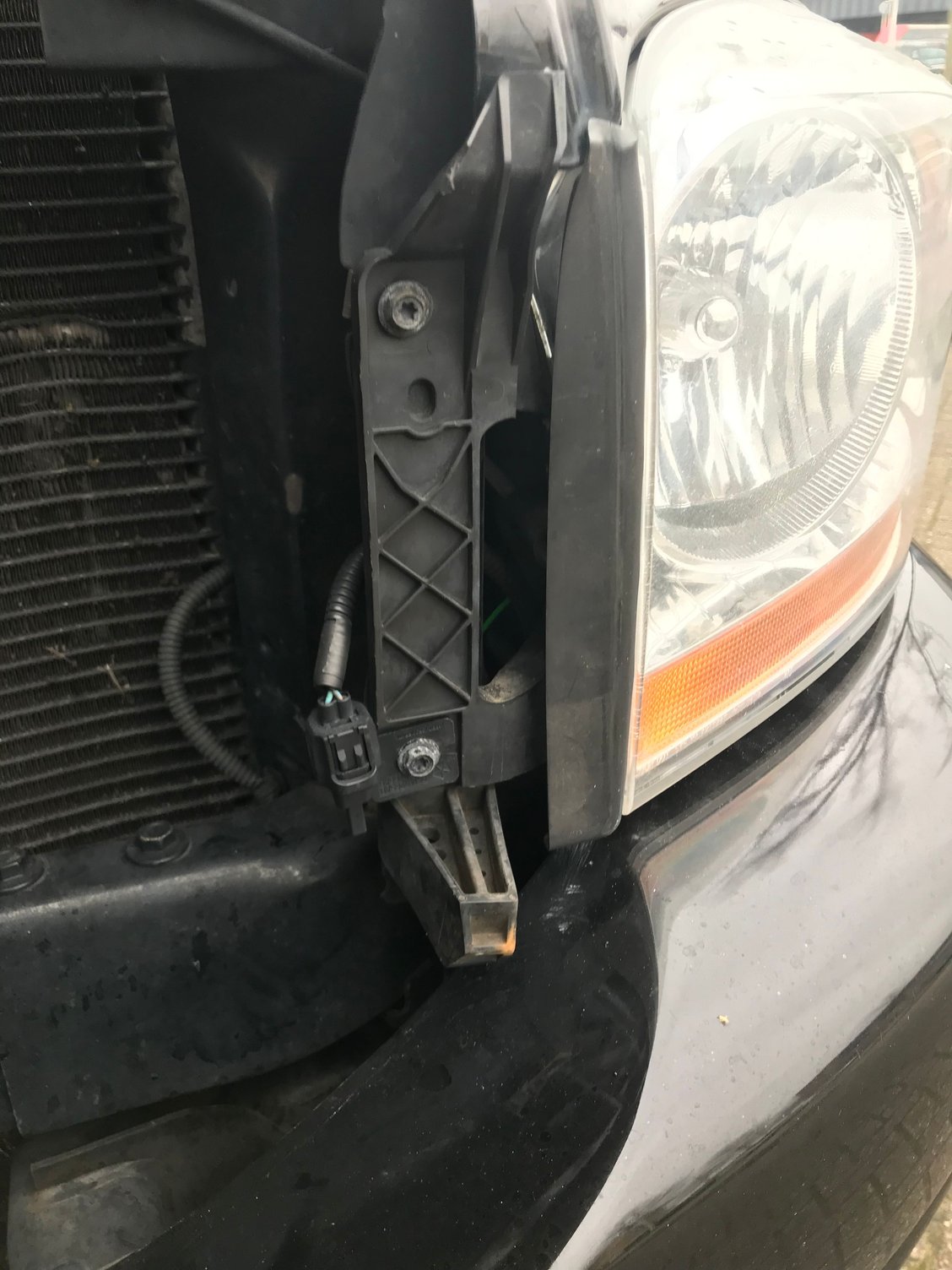

Second: on my drivers side headlamp bolt there is an extra electrical connection mounted on a bracket for future use. Does anyone know what the function of this wire is, or can be? Haven’t found anything in the manual yet.

Here’s the connector I was talking about. Any ideas?

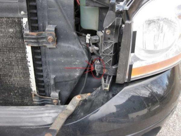

Quite possibly the connector for the ambient temperature sensor as seen here. Just taking a guess.

Well, got that figured out. That connector I was talking about is from the ambient temp sensor.
