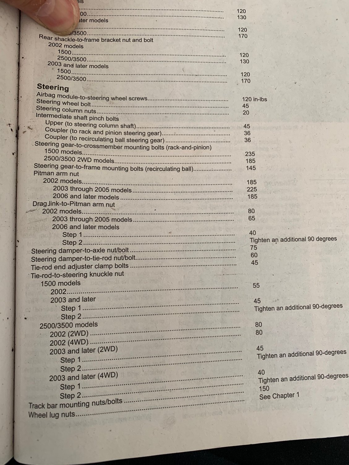

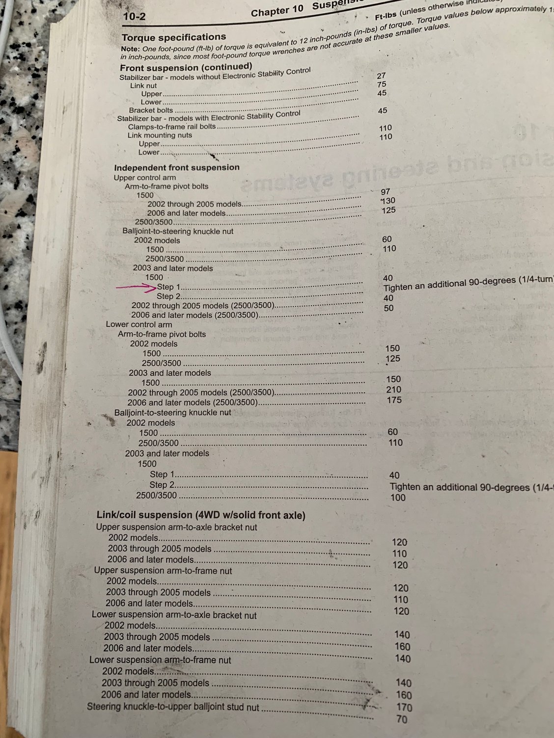

Old Jun 3, 2019 | 01:11 PM
smurphy596's Avatar
smurphy596
Joined: Jun 2019
Posts: 6
smurphy596's Avatar
smurphy596
Joined: Jun 2019
Posts: 6
