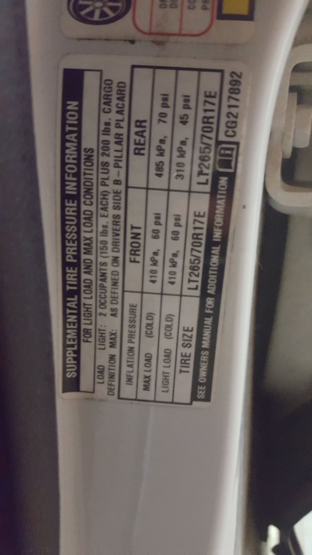

60 front
45 rear
From my 2012

Thanks @TrueDogman . Just what I was looking for.
