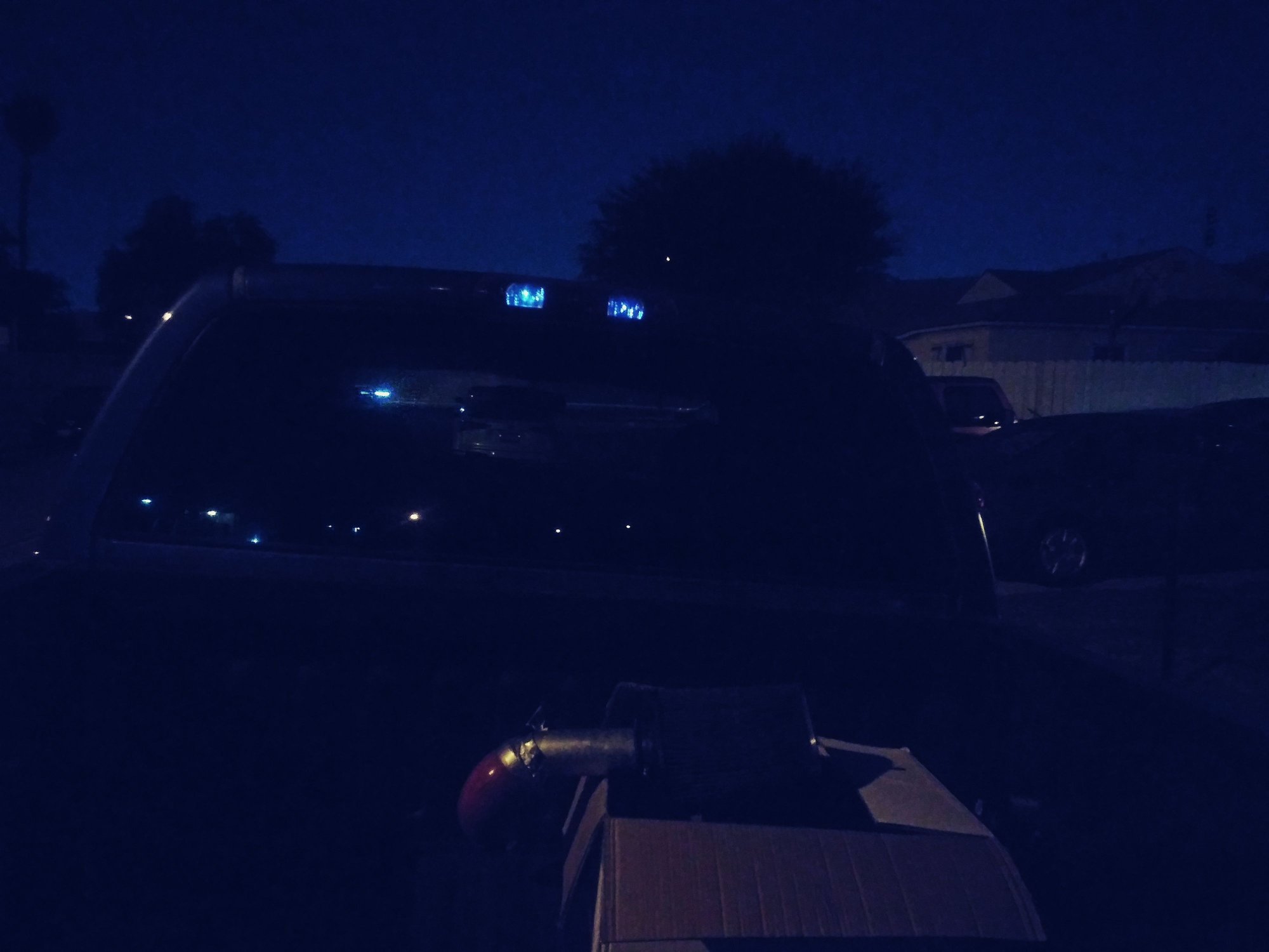

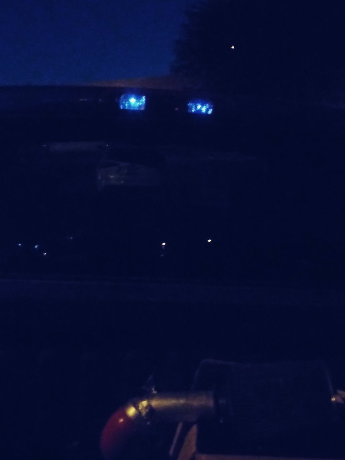

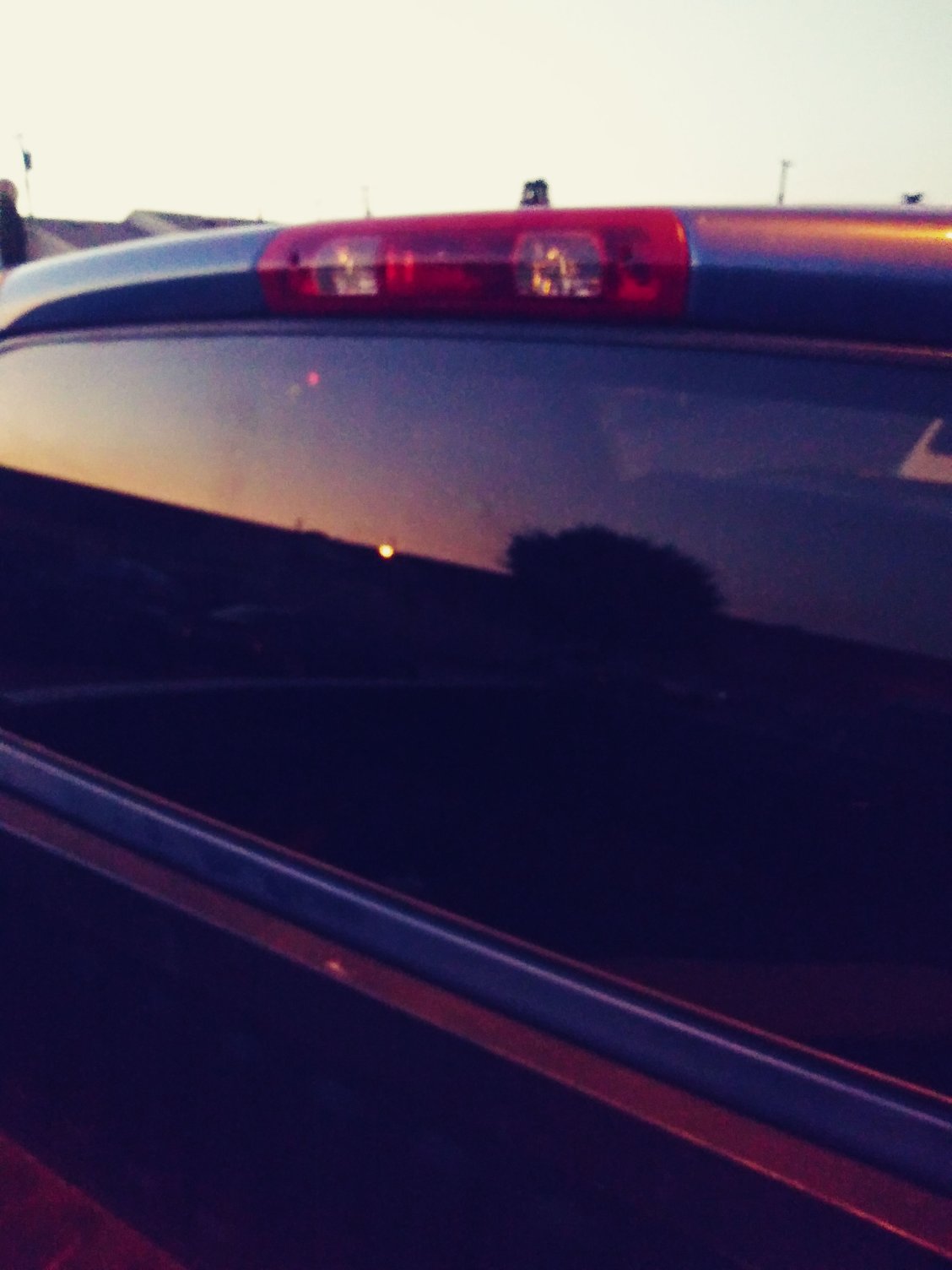

Im having a issue wit my 2003 dodge ram 1500 were my cargo light stays on is a very low dim any clue ive tried disconnecting a few fusses but it stays on.
Having this issue were my cargo lights stay on on a low dim any idea why

Is it LED?

Yes there led bulbs
Sometimes LED bulbs stay on a tiny bit for some odd reason... when I had my aftermarket light it would do the same thing. I went back to the stock light and threw on led bulbs inside instead. I linked the ones I used for my truck when I had it below for you.

Hey thanks i got the led bulbs you linked on amazon and it work i guess the led bulbs i had were cheep i was thinking i had an electrical problem fix the issue
