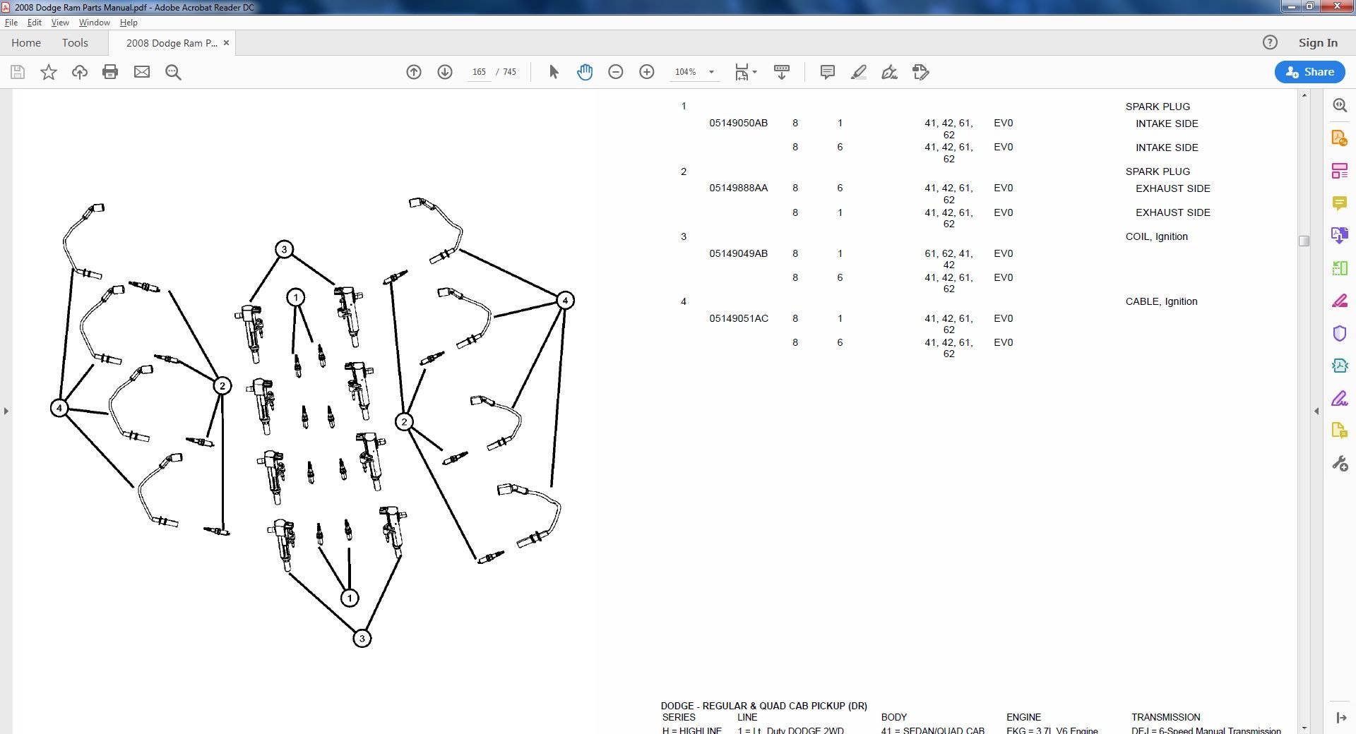

I need to get new spark plugs, and found out today that there is 2 plugs per cylinder in the '08 4.7l. Stock part numbers are saying they are Bosch plugs. But I was always told Champion plugs are best for Chrysler engines. Also its stating copper for the top plugs and iridium plugs are for the bottom plugs. What are the best plugs to put in? I don't remember how to start my own tread, sorry.
Old May 23, 2020 | 05:07 PM
Magnoom's Avatar
Magnoom
Veteran: Navy
Veteran: Coast Guard
Joined: Apr 2019
Posts: 1,680
Likes: 262
You're probably getting the whole Champion thing for 03-08 hemis, those do work better for them. You are correct, the upper and lower plugs are different simply because the lower ones are harder to get to; if you look in your owners manual you'll see the they have different replacement intervals. What you want for yours is:
