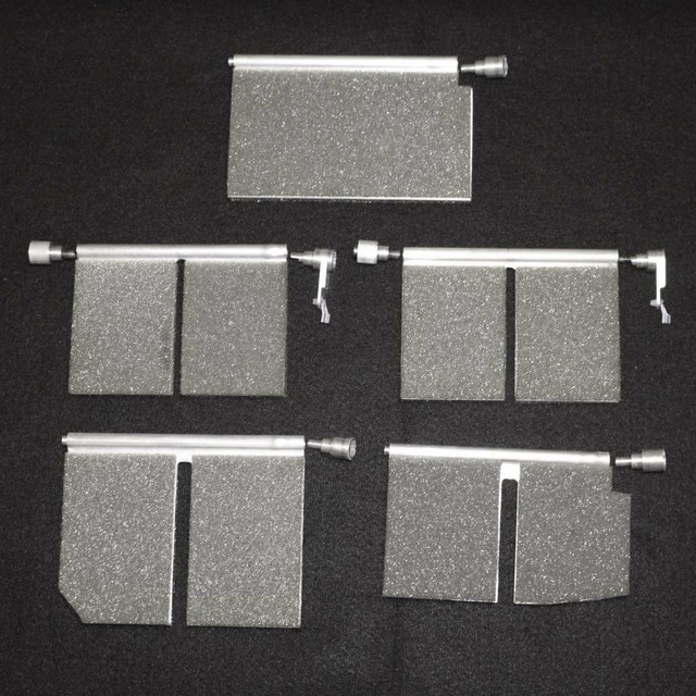

Unsure but there are 5 blend doors on my 04 4wd ram 1500 , I had to pull dash and change all of them , no trouble since but yours may have some differences , you might check and make sure the actuator is hooked up properly but there is more than one blend door and actuators , or fittings on the actuator could be bad striped busted ,,not saying its not another electronic control issue but the doors an actuators are notorious for breaking
