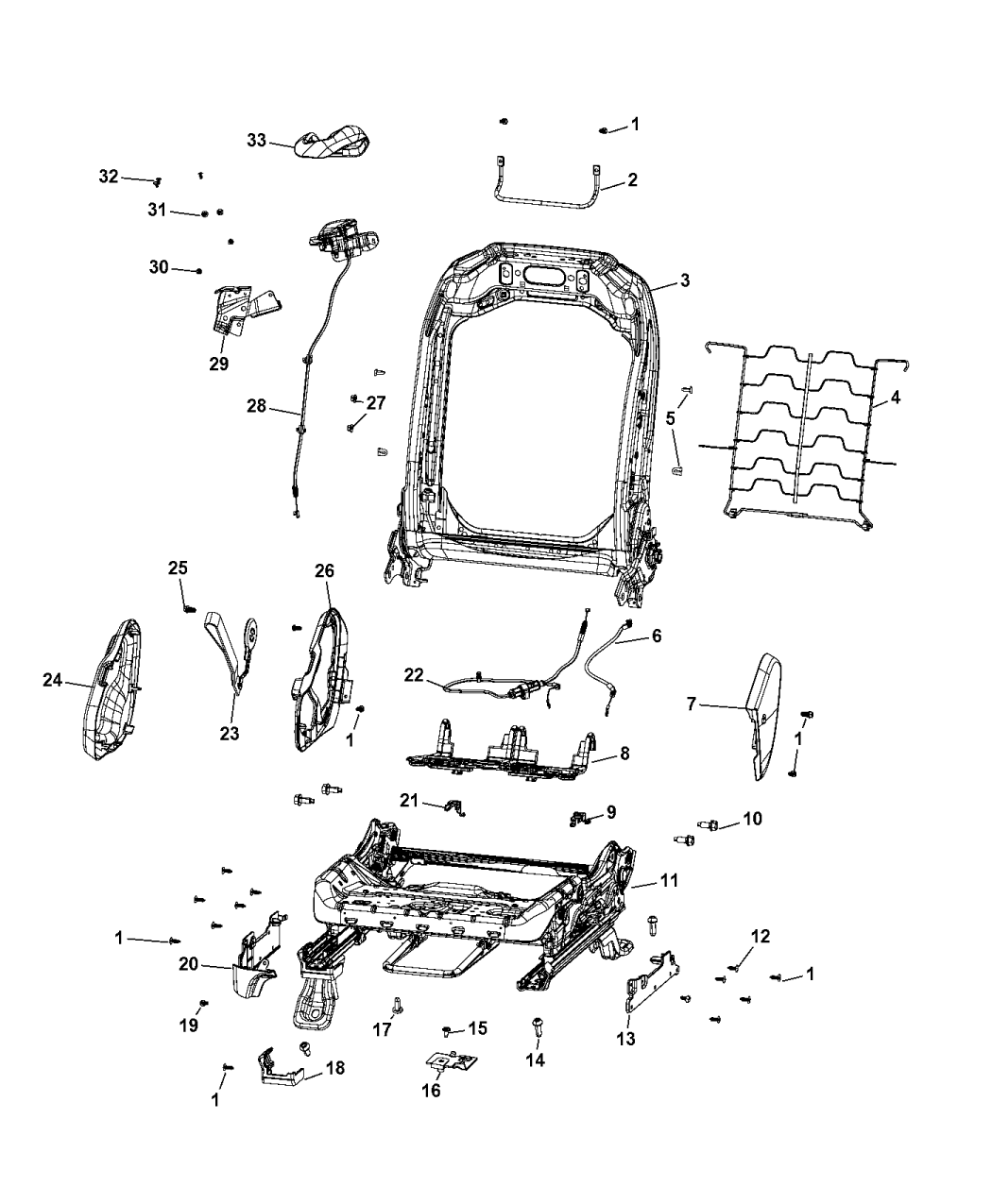

I had my 2005 Dodge Ram Quad Cab SLT in for a wheel alignment. Tech accidentally pinched metal brake line on passenger side. Because part was discontinued, shop spliced a new piece. There is no guarantee that this will be equivalent to the OEM performance. In 15 years, I have not ever had a problem with my metal brake lines (51K miles). Everything on my truck is Mopar part replacement when needed. How do I go about getting a new OEM like line made? Few shops in the area do this type of work. Yes, I live in small town USA. A picture of the OEM part is shown below from Dodge.
This is where his tool pinched the brake line on passenger side
Mopar 52122133AA
