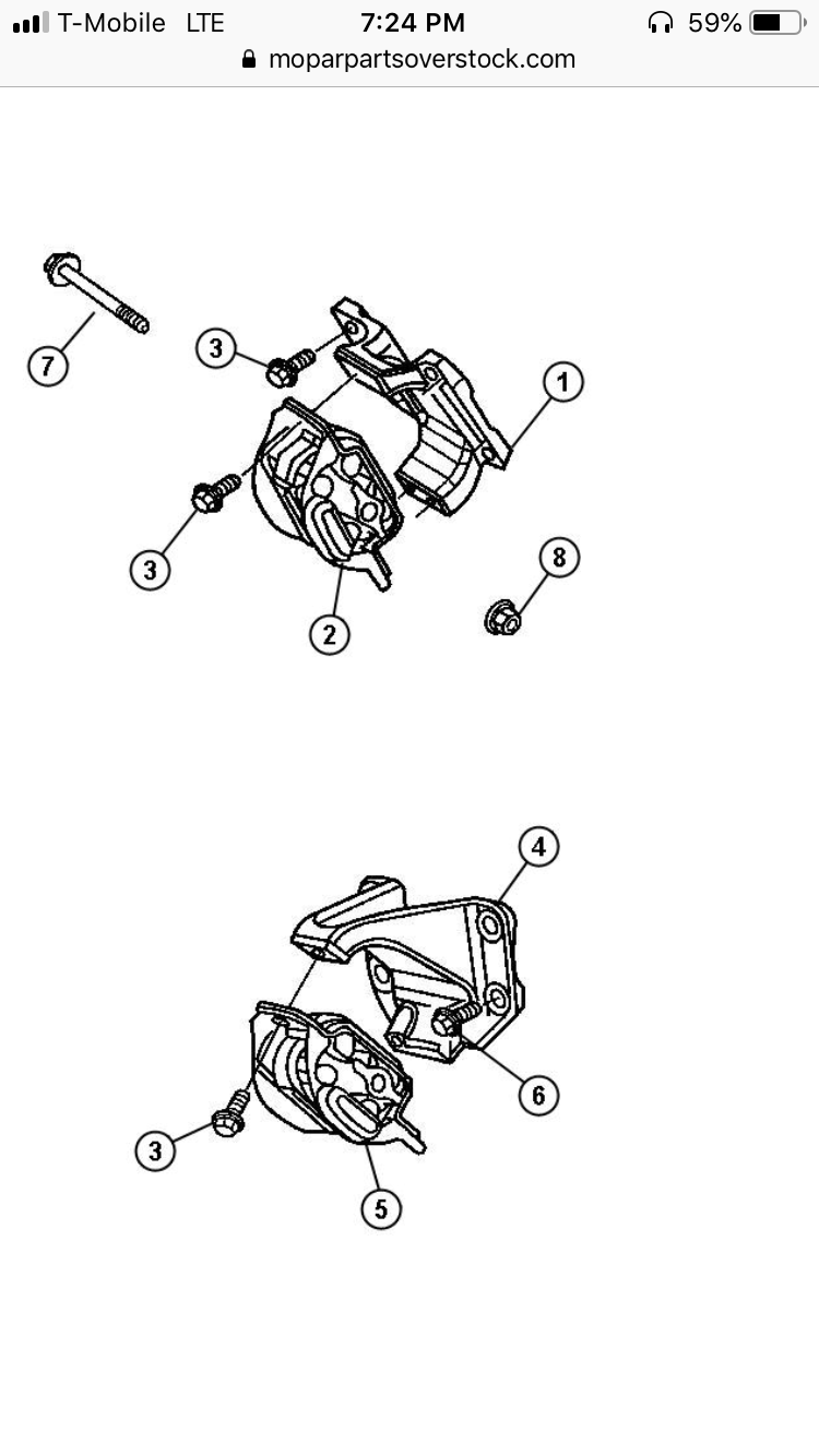

2005 ram 2500 5.7 hemi. Had to do overhaul for my father in law. Motor mount brackets are confusing and I tried both positions and swapped and want to make sure it’s right. Does anyone have a pic of the motor mount bracket as it should be set up? I’ve looked everywhere and cannot find one. I need to get this motor in tonight and need help.
What bracket goes on what side of motor and which way is up and down? Thank you.

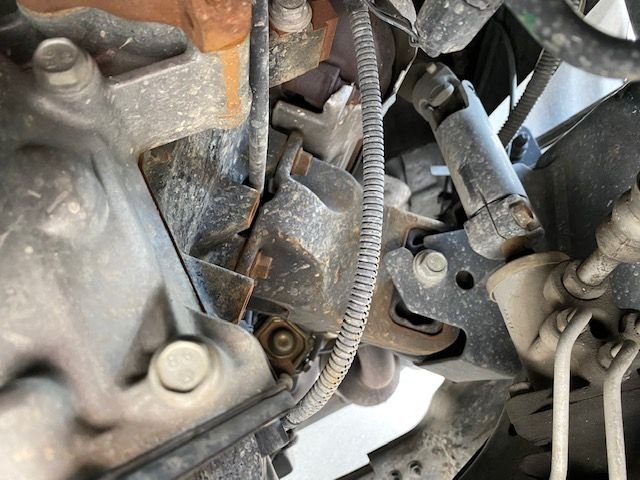

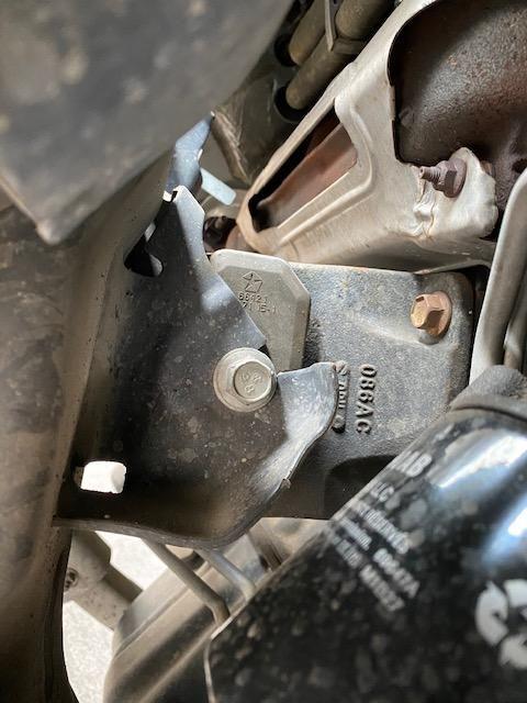

I just went and got some photos of my 04 Hemi for you. Hope they help.
Driver's side from front of engine.
Passenger side from front of engine.
