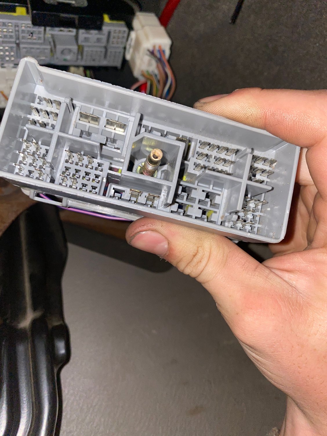

I have a 2003 ram 1500 with a 4.7. Have had it open time after time and runs fine now just tired of no power. I have a 05 Durango I took the engine out of and I have absolutely everything with the truck. I’ve done my research and know what I need to do to get it in the hole but the 05 harness plug (engine to body. Under dash with one bolt) is different then the 03. Looking for a pin diagram for both trucks to repin my 05 engine harness and 03. Or should I just try to find a 03 hemi engine harness

Buy the wiring harness. Engine swaps are difficult enough on their own, repinning a connector like that is a total PITA to add on top of that!
