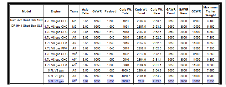

I bought a 2004 QC 4x4 SLT with factory tow package new. It had the 20" wheels so it came with 3.92 ratio ring/pinon gears. I had a 7500lb 18ft car trailer and towed many miles with that setup w/o issue. That truck did come with extra coolers, ps and trans - not sure if that was a tow package item - but you can add a cooler. It would squat pretty good if I had the load too far forward on the trailer, so you want to make sure your trailer is balanced well. Doesn't hurt to have an equalizer hitch either, especially if you plan to hit the highway often. Mine came with a hitch and both 7pin and 4pin harnesses. Also the blue socket under the dash, as well as a adapter plug in the glove box for a brake controller.

Google is your friend... check out the picture halfway down.
https://www.etrailer.com/question-108470.html
