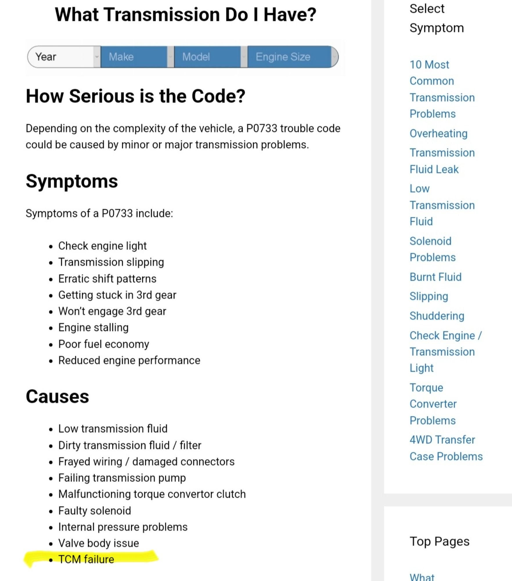

kiss of death or bad tcm ( pcm) ? I'm just saying just because that happened on your 5.7 doesn't mean this can't be a pcm issue , I may just replace it 1st can't hurt to have a new pcm .
