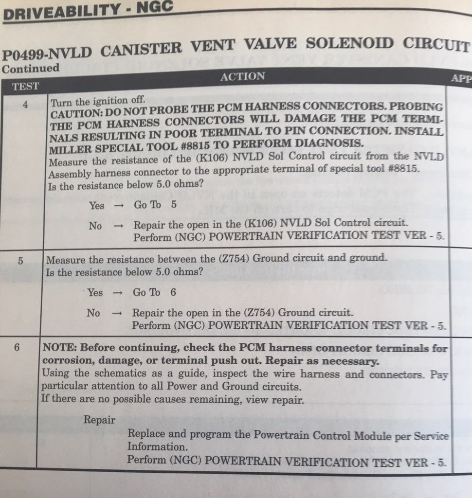

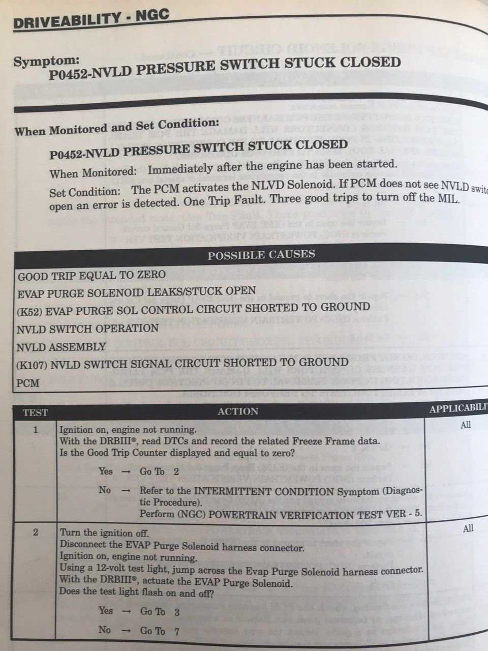

Early Gen III uses similar system to the late Gen IIs. Small vacuum pump to check the integrity of the system. Any pinhole anywhere in a line will set a failure code. Believe P0499 is big(ger) leak, or failed purge valve. P0452, which my '03 carries is small leak. I have the factory manuals in print if you need help.

Once you have the codes, with some thought, most of this can be diagnostic with your existing tools. DRB just simplifies things.
