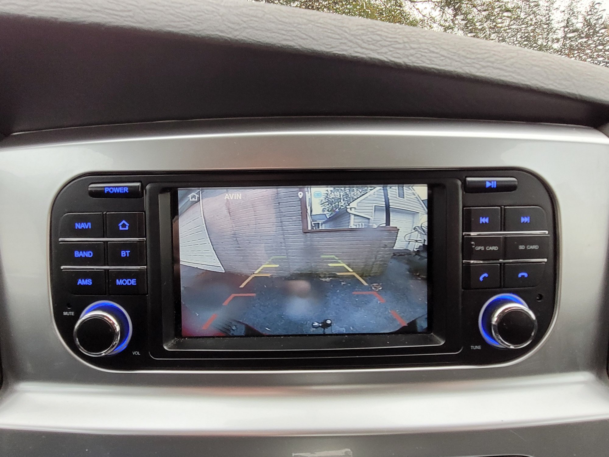

Plug and play Android head unit with backup cam:

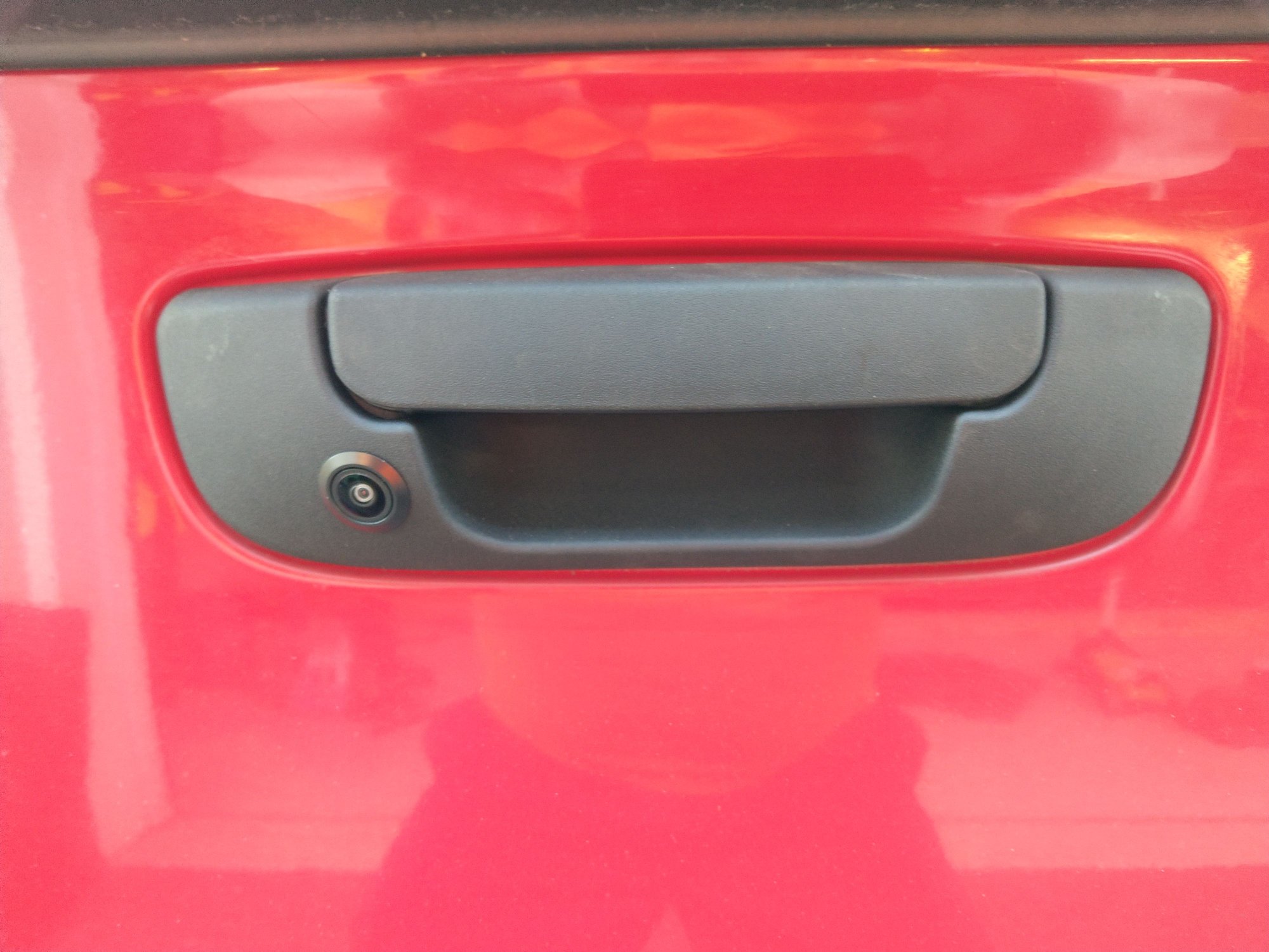

@Magnoom, license plate camera mount, or ? Is that a metra dash kit? Have to hack the dash support to install? What head unit is that?
Looks to me like a master tailgater camera, or maybe a similar brand, I have one in my 06, great quality camera, but the handle does not like cold weather

It's actually a site called 'tailgatecamera.com' lol: https://tailgatecamera.com/collectio...2008-dodge-ram
Did a bunch of upgrades a few years ago; coupled this one with a power tailgate lock (ties into the stock power lock system):
Stock 02-05 dash, no hacking. I wanted a head unit that would fit the stock opening and have all the capabilities I wanted, including properly interfacing with the stock Infinity amp. Actually found one by a company called Insane Audio. It's not cheap at all, but it is plug and play and they have very good after purchase customer service.

It does fit nice, looks like its made specifically for that radio opening
It is, and that was one of my requirements.
How cold is it where you are? I have the master tailgater camera and the handle did not like below freezing temps, they would warranty them no problem but after awhile it got old always having to break into my own box (tonnue cover) so I swapped the handle out for an oem dodge one and never another issue, still using their camera housing on the outside

Gets into the single digits here sometimes, never had a problem with it though.
