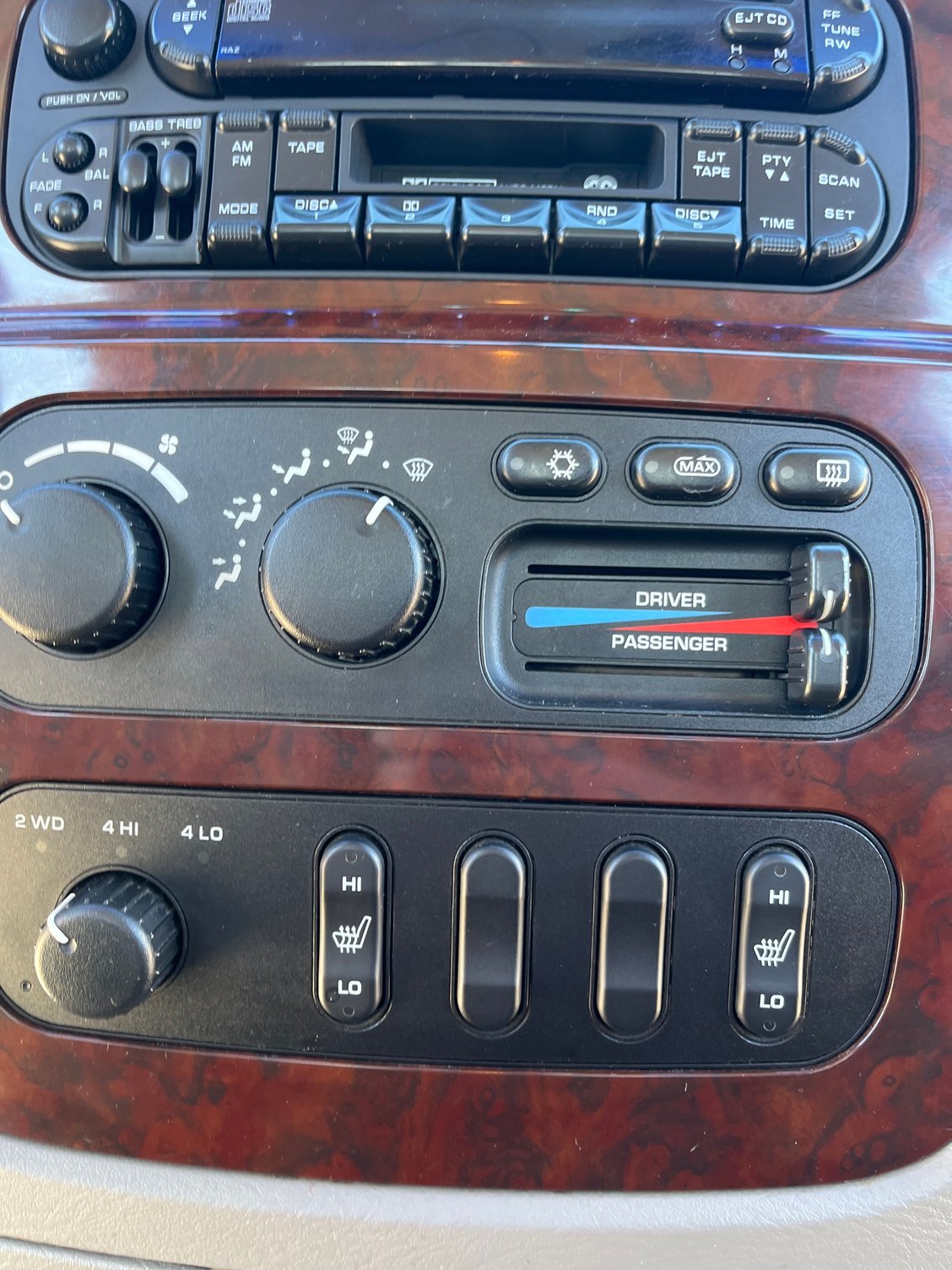

I have a 2002 ram 1500 with the dual climate control but my driver side blows hard but no heat and my passenger side blows heat but not hard
Does anyone know how to fix or what it's caused by?

Likely blend doors broken... This website has some good info. See if Dorman still makes them, cheaper through them.
https://www.blenddoorusa.com/collect...odge-ram-truck
