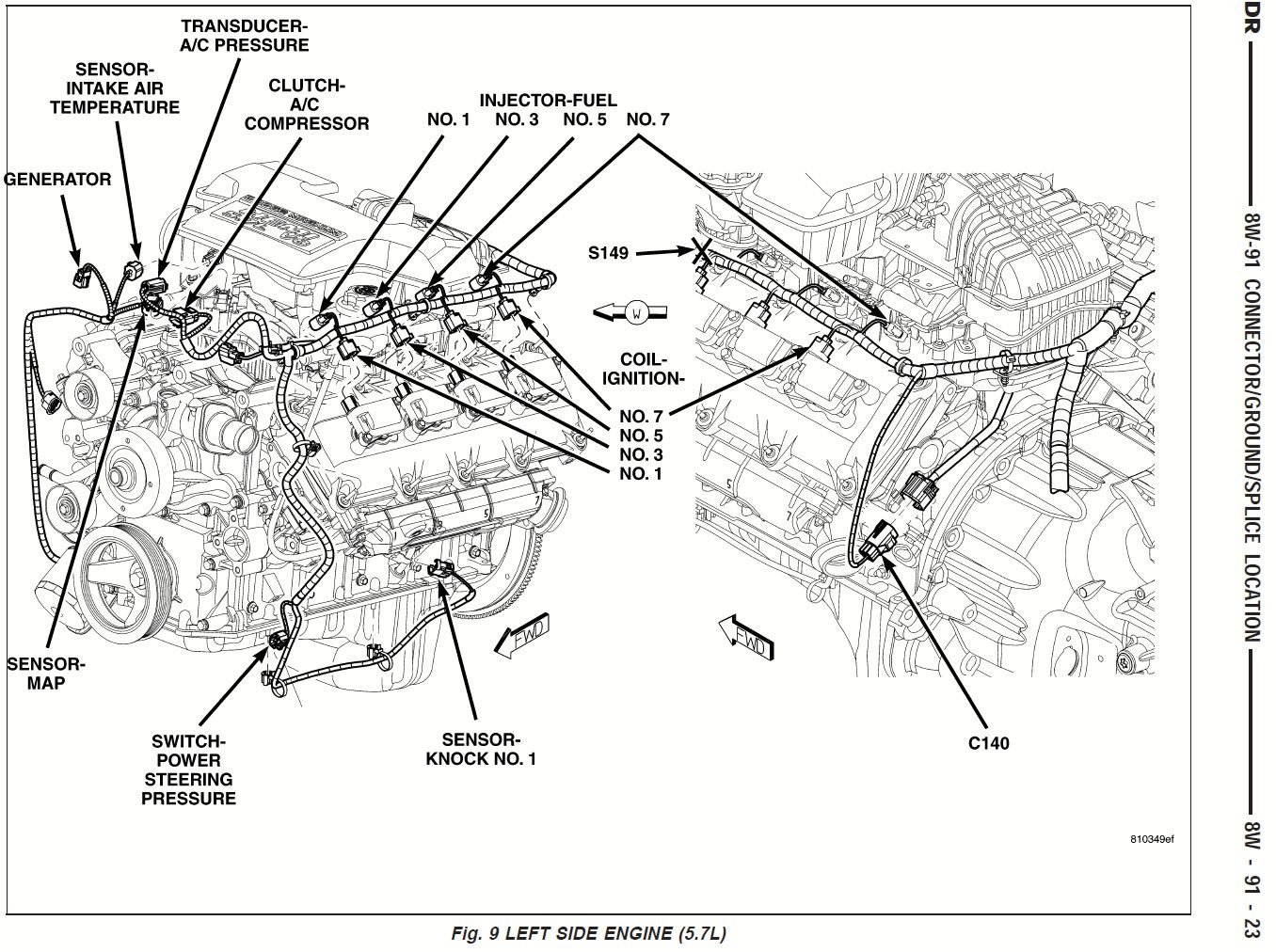

So I did a big rookie move while replacing the motor on my. 06 Dodge Ram mega cab 1500 I buried the wires that plugged into the pressure switch somewhere and I cannot find them. Does anybody know where they originate from?

Harness that runs around the drivers side head.
thank you
