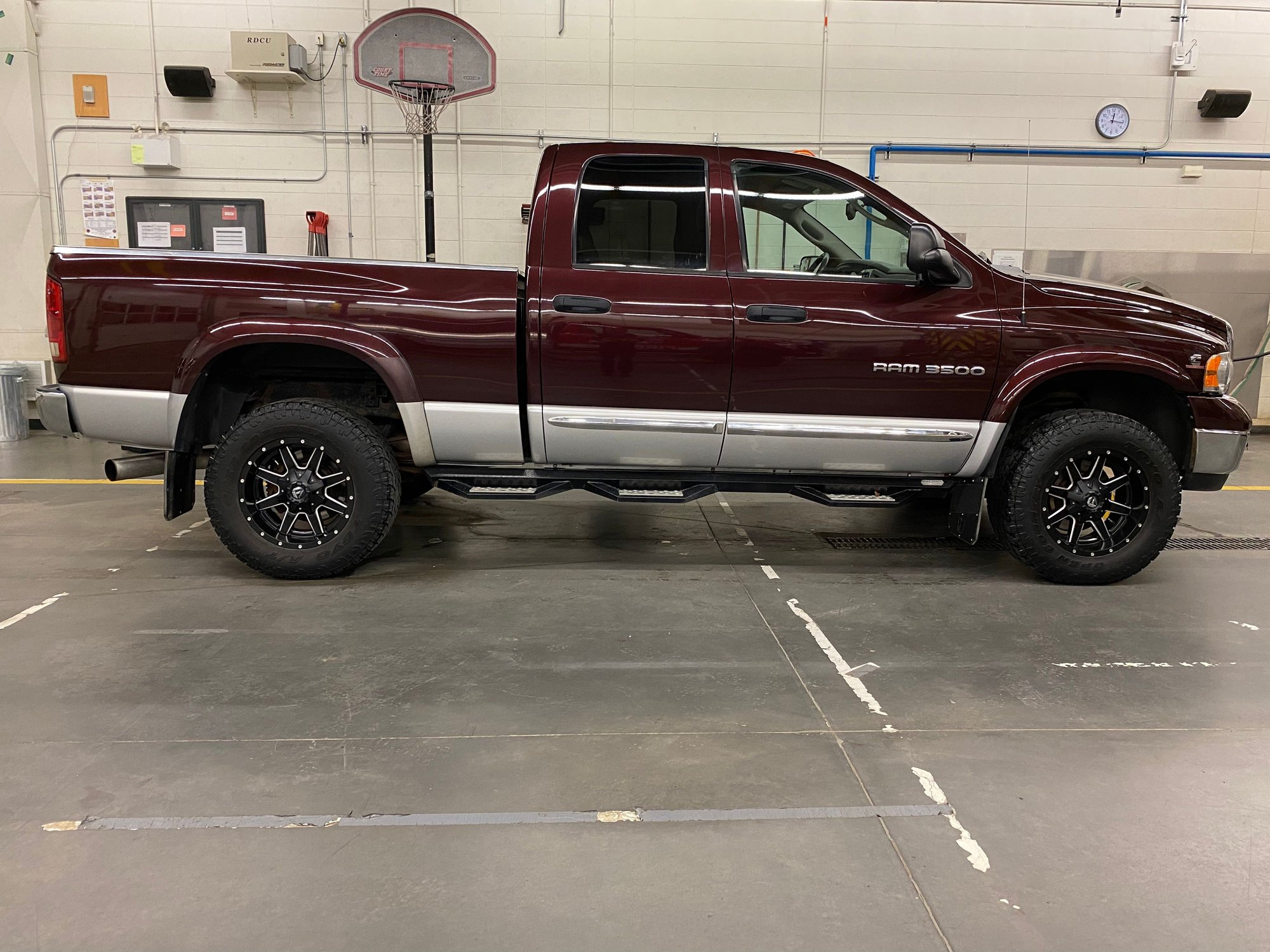

I have a 2005 3500 diesel with 108,000 miles, trying has been babied it’s entire life. It has multiple electrical ghosts. Where you can take the key out of ignition open the door and the door chime goes off as if key is still in ignition and radio still works. That’s problem 1. But it seems to have fixed itself for now. The issue now is I drove it the other day no issues, parked it and today I went to drive it and it’s stone cold dead on the driveway. Thought batteries were dead, nope tested those. Radio works, door locks work, headlights, wipers. Odometer lights up, but no lights to show it’s in neutral or drive. put the key in and door chime works, turn to the acc position and no warning lights light up, none of the gauges move. Is this a ignition switch problem or a steering column switch or a anti theft module. Completely lost on this, ready to burn this truck. Thanks for any advice from the many knowledgeable people on here.

ya just the odometer under normal operations. I installed a new ignition starter switch, which the end of key barrel lines up with and turns a switch inside it. Made no difference.I heard tilt the steering wheel up and down maybe a broken wire at the pivot point. Made no difference, but that is my next task to inspect all of the wires where they bend. Truck was working fine, parked it and next time i went to use it, its in this state. Truck isn't a daily driver, maybe puts on 5000 miles a year. tows a small bumper hitch camper twice a year maybe 1500 miles.
