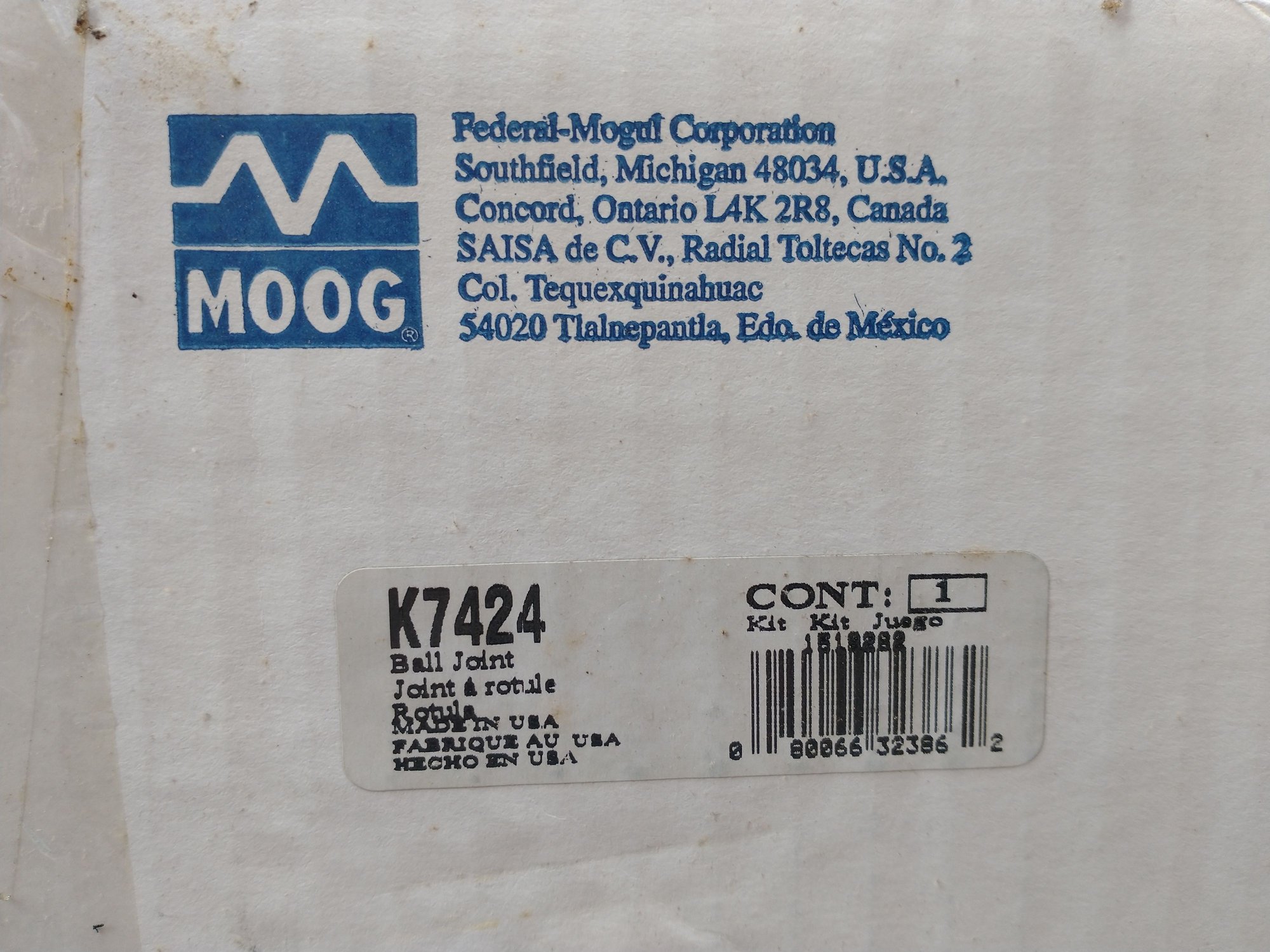

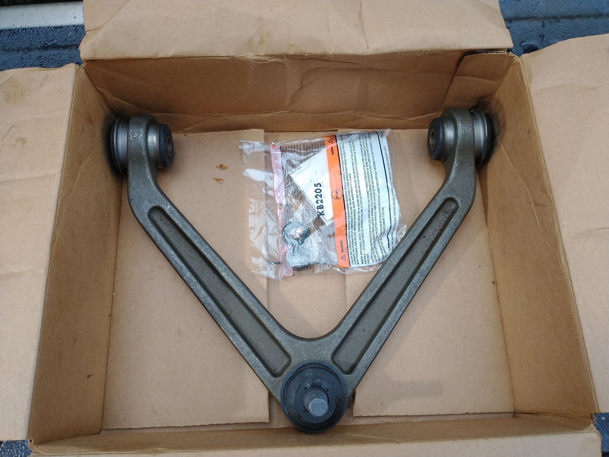

I have one old stock moog (made in usa) upper control arm (and grease-able), leftover from my 04 1500. I have it on ebay, but could sell it direct for cheaper. If interested, email me. K7424 is the part number.
You may consider replacing the wheel bearings as well, easier when you have it all apart.
