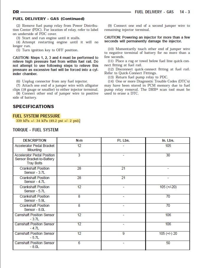

Incorrect. 2003 hemi (2003 everything) typically runs 48 psi fuel pressure (specifically 49.2 ± 2). 2004+ run the higher pressure. This is why the injectors are different (as well as fuel pump).
So far the engine i took out of the '05 Durango runs good with the '03 injectors and pump. Is this something thats going to come back to haunt me? I figured the '05 5.7 was the same as the '03 and could use the injectors and fuel pump in the '03 truck to power it. Just dont want something catastrophic happening later.
