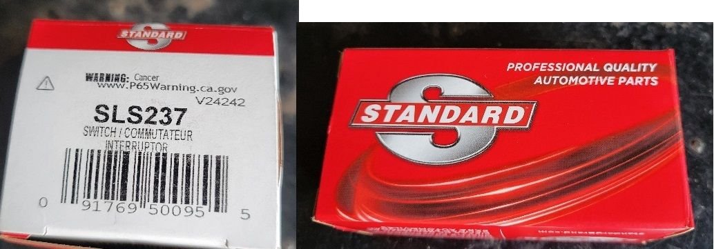

2003 1500. Battled intermittent cruise control issues for several years. It would engage and set. Then just drop off. Changed switch, worse. Checked all the usually culprits. Finally found one guy's online fix. Brake light switch. All my lights worked as expected. Figured I give it a shot. Got one from RockAuto $20.97 shipped. Took like 3 minutes to replace. FIXED...
